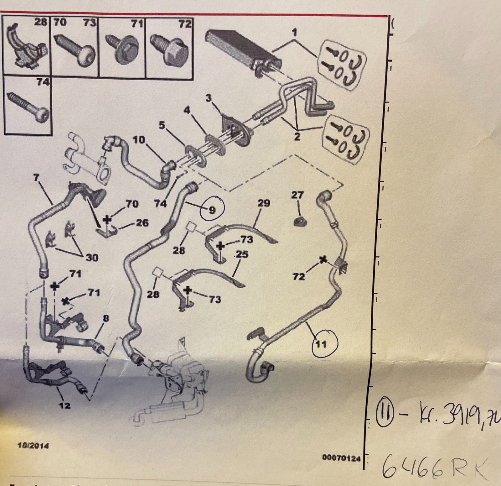

I discovered the leak coming from the back left-hand side of the motor, trickling down the inside of the left side front wheel. Very red, very coolanty smell! Looking from above into the motor, I can see a pipe or hose bend that is covered in a mixture dirt and red fluid below the brake booster:
I had a local garage look at it and they came back with some photos as well a part diagram with the suspected faulty/leaking part: 6466RK (number 11 is circled on the parts diagram) The diagram was sent from the nearest Citroen dealer/garage, which my local garage had been in contact with for some advice.
What gets me is that, the local Citroen dealer/garage have no experience with this and could not put a timeframe on the repair and the claimed they did not have the instructions for the correct procedure. Furthermore, the part in question ( 6466RK) was unavailable.
OK, I get it- my car is getting old, but I was hoping to have it a couple of years more. Its mileage is only 165000 km and the whole family loves this car. Hope you guys can help. VIN number is VF7**************[VIN obfuscated, can be read by forum staff]

According to my live data that part IS still available from Citroen, using their own live parts database. It is not marked as NFP, which indicates it is available.
