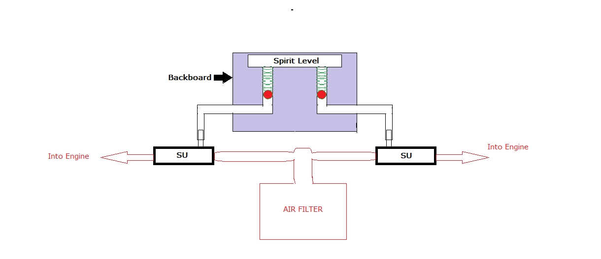

A mate of mine made himself an SU balancer using fish tank tubing, a pair of biro springs and a couple of ball bearings which sat snugly in the pipes. When connected you adjusted until the balls were at the same height against the springs. I can't remember how they were attached but it may have been araldite!! :-D

The layout for the balancer was something like this:
MTMO
MTMO

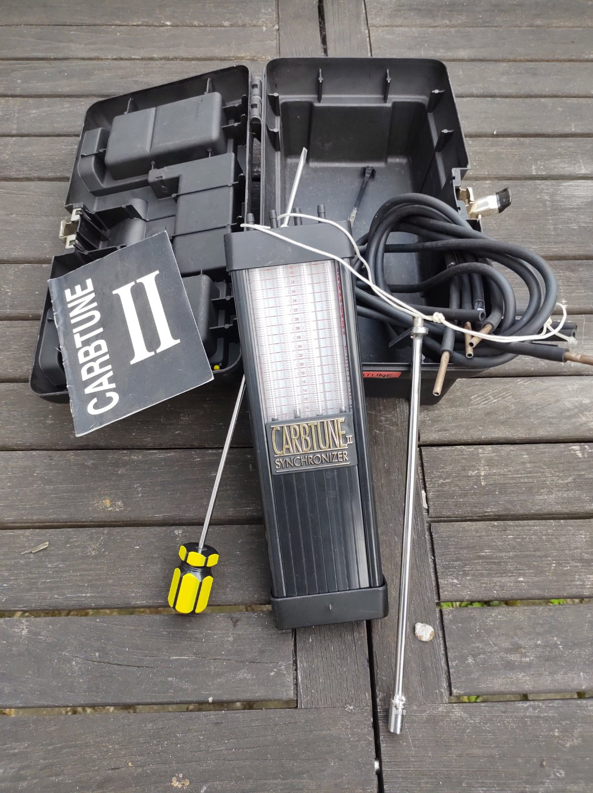

CitroJim wrote: 10 Oct 2023, 14:34
Back in the 80s when I used to run motorbikes with multiple carbs I had the manometer set of four glass tubes with U bends in them and filled with mercury... Would never be allowed these days! It worked brilliantly though - the carbs had special test ports on them on which the manometer tubes could be connected for balancing adjustments...
This is the modern version, made by the same lot that did the mercury ones, I think. They use a metal slug in each tube in place of the mercury.
Carbtune kit - own work
