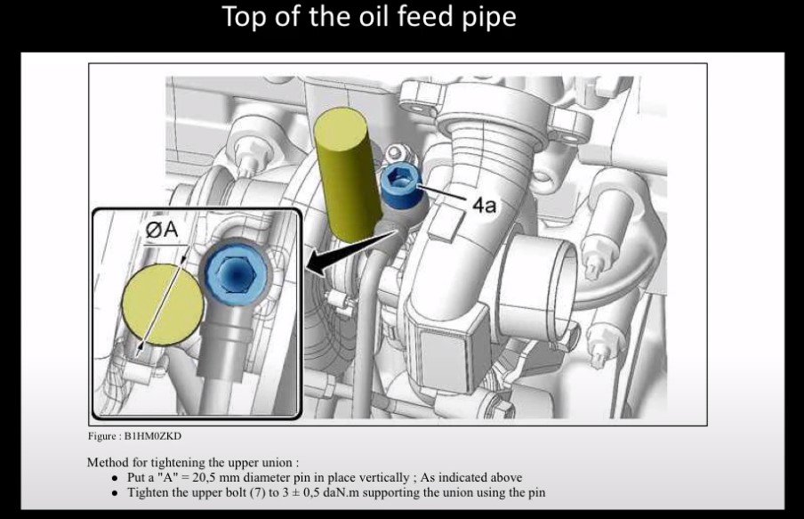

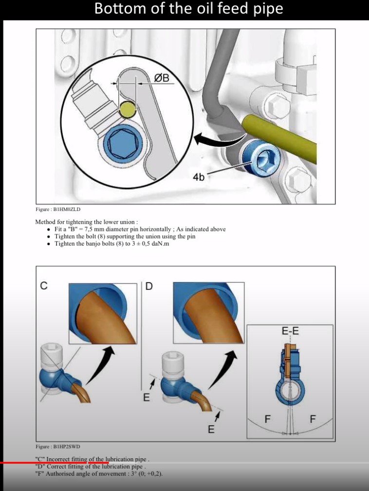

I ordered some broken pieces and tomorrow they will arrive.
Is there some place to look for torque values for screws?
I must reassemble the oil conduct from engine to turbo with the new banjo that has bigger filter.
And all the DPF with thermal shields, they were broken in particular the back one... I bought a new one.

I found the assembly instructions in a video from a guy on youtube, they are 30Nm +/- 5NmCitroJim wrote: 01 Sep 2023, 05:16 As for torque, those with access to the information may be able to advise but generally, just use your experience and common sense.
Here are the pics also with spacers to center the tube Here is the video
