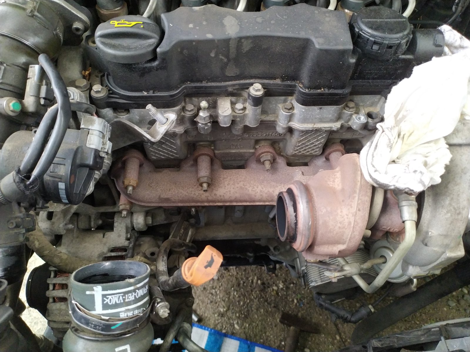

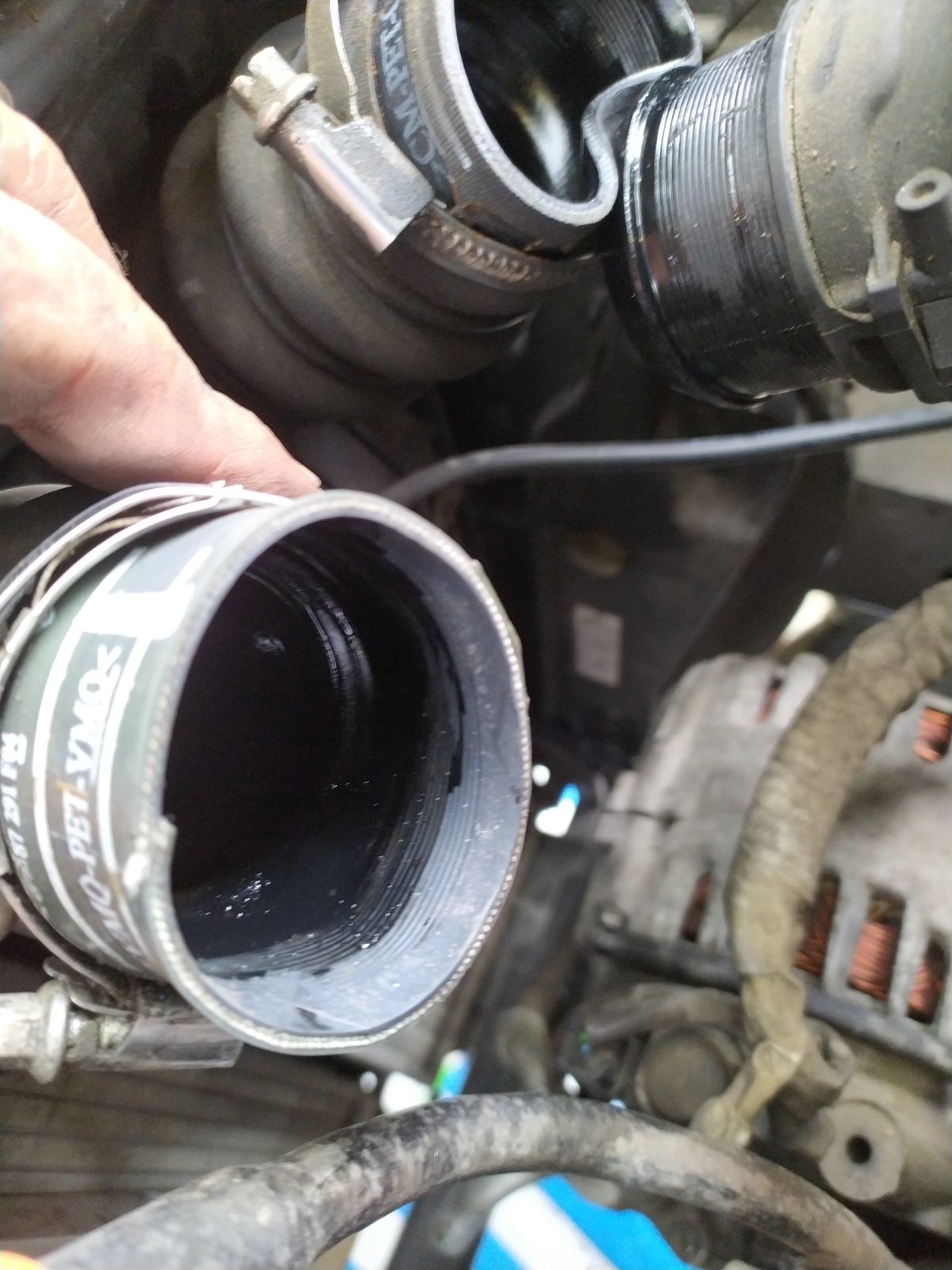

On the turbo side oil was much more..
Didn't take a picture.
And the car makes lot of black smoke if I push the accelerator.
How do I diagnose a bad condition turbo?

Remove the intercooler and hoses and clean them thoroughly.
Made a huge difference to my C5.

A failed turbo will either cause much oil to be burned - blue and smelly smoke - and be horrendously noisy or will cause very poor performance from being seized. If seized, this can cause black smoke as the engine cannot draw in enough oxygen to permit full combustion.pieri70 wrote: 30 Aug 2023, 18:27 And the car makes lot of black smoke if I push the accelerator.
On a diesel, blue smoke is oil being burned, black is incomplete combustion due to lack of oxygen or a bad injector spray pattern and white smoke is unburned diesel where absolutely no combustion has taken place...
If you have black smoke, before condemning the turbo, check the air filter and all inlet air trunking for blockages/obstructions and check the intercooler is not blocked... Then have the injectors checked if the problem persists.
I've seen cases where a pipe between the air filter and turbo inlet was squashed, thus strangling the engine of air and causing it to make black smoke...

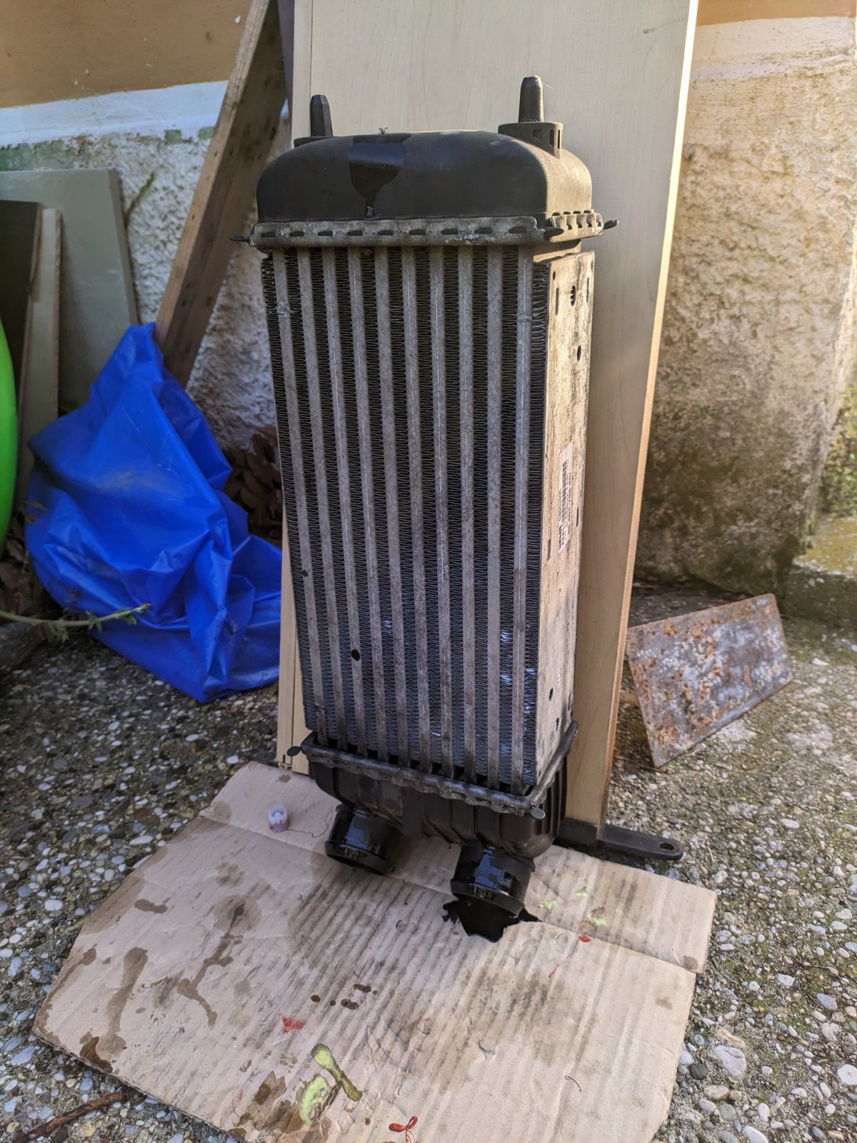

Ok,
How can I clean the intercooler?
Live it some time upside down and some thinner then water?
Ok like in the picture? Thanks everyone!

Yes, fill it with solvent such as carburettor cleaner or brake/clutch cleaner and dry it very thoroughly... I'd blow through it using an airline. That will give you a good idea of how clear it is...
DO NOT use any water under any circumstances... Any remaining could cause a lot of grief!

Ouch!CitroJim wrote: 31 Aug 2023, 08:44 DO NOT use any water under any circumstances... Any remaining could cause a lot of grief!
Too late
looking at some videos I cleaned with gasoline (2x), degreaser with hot water (2x), disk washing and hot water(2x) and then hot water alone until transparent water was flowing..
Now I let it outside upside-down. I'm not in a hurry so I can leave it there for 2/3 days..
To be sure that no water is inside I can hook up a vacuum an let it for some time

That's a very thorough clean-out
If you can be sure there's not a drop of water left inside the intercooler all will be good...
Good plan! That will be finepieri70 wrote: 31 Aug 2023, 08:55
