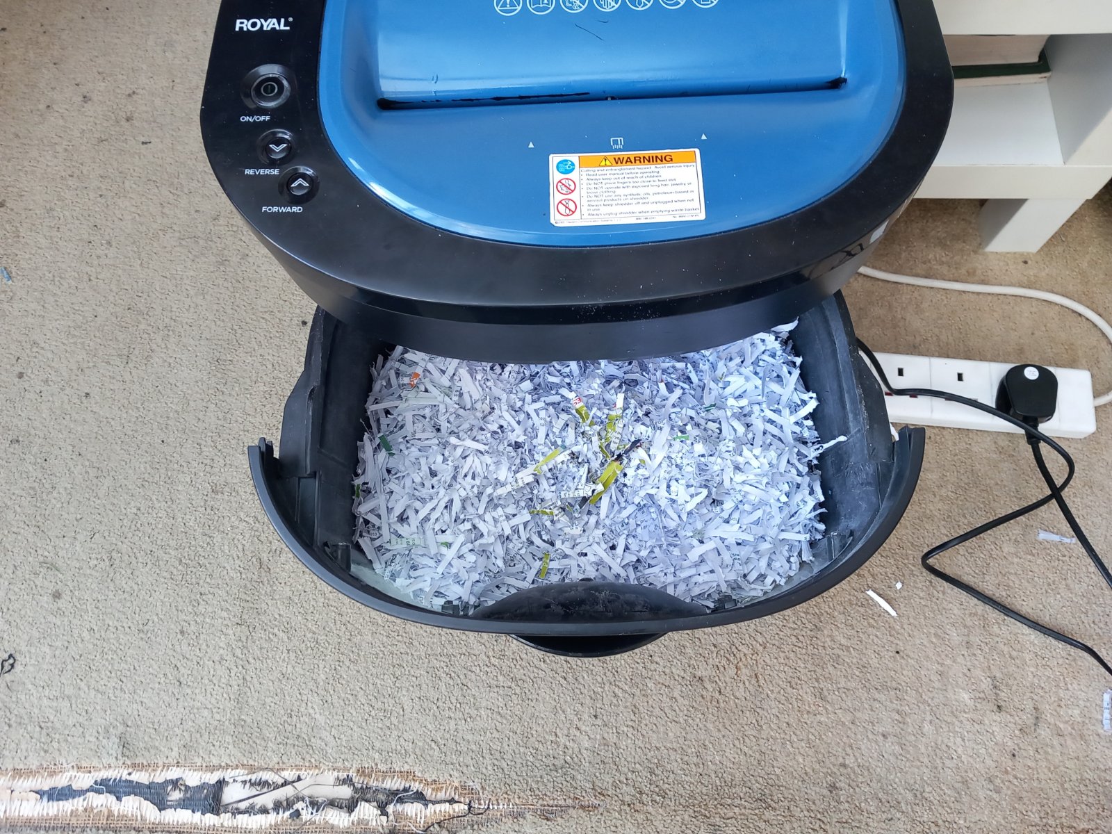

Lots of good progress today
I turned up the second bearing on the lathe and reassembled the gearbox..
And did some testing. All is good
This was after shredding a while load of test material... Lots of old, thick documents I should have shredded about ten years ago!

I now have to check for wear on the new bearings after a lot more test shredding and then I need to make sets up for the remaining two shredders...

In my initial testing today James, I'd be reluctant as given how well lubricated it is, the shreddings have ended up a bit oily... That won't be good for the pets I'd have thought...Hell Razor5543 wrote: 30 Aug 2023, 18:04 I know of somebody who (with permission from their boss) was using the shredded paper as bedding materials for their small pets. Clean, dry, and after the pets had used it for a day or so, even more secure!
