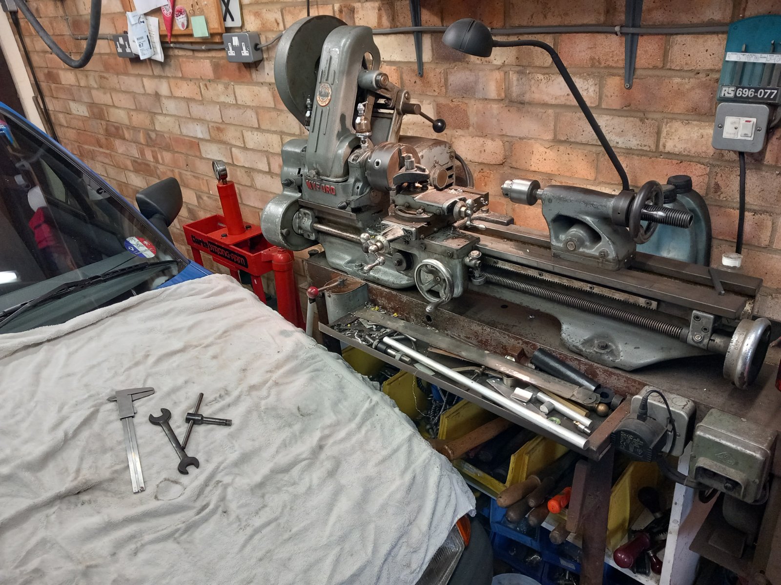

I did all the lathe work without having to take Bluebell out of the garage! That's a very thick towel on her bonnet to protect her
