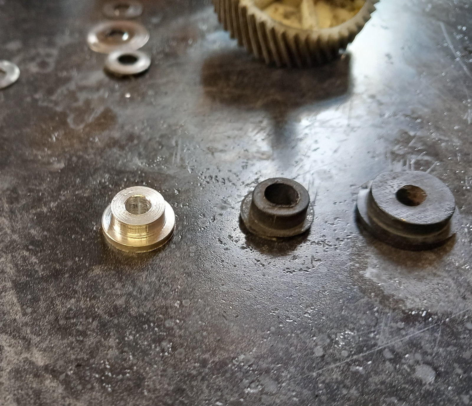

Last week, Mick acquired a trio of cross-cut shredders for a tiny sum of money. All three have the same problem - very worn nylon bearings causing the first gear to fall out of mesh with the motor drive gear. I'm in need of a decent shredder to dispose of a mountain of personal papers and these will do the job beautifully once fixed.
I've turned up on the lathe the first of a series of new bearings out of what I hope will be a more suitable material - or at least stuff that will last long enough to do the job. For the bigger one I have a nice lump of phosphor bronze...
The extent of the wear can be clearly seen. A 5mm hole has opened up to over 6.5mm

Lots of good progress today
I turned up the second bearing on the lathe and reassembled the gearbox..
And did some testing. All is good
This was after shredding a while load of test material... Lots of old, thick documents I should have shredded about ten years ago!
I did all the lathe work without having to take Bluebell out of the garage! That's a very thick towel on her bonnet to protect her
I now have to check for wear on the new bearings after a lot more test shredding and then I need to make sets up for the remaining two shredders...
