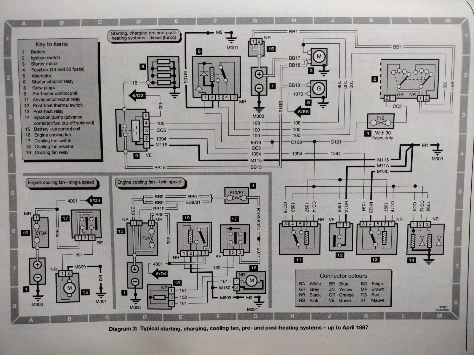

Here's the "from 1997" central locking diagram (306. No mention of one touch)

Have you got a 306 diagram showing the diesel pump and immobiliser wiring Matt? It may be combined with glowplug control and/or starting and charging arrangements.
'One Touch' refers to the electric windows - one touch to take them all the way up or down...

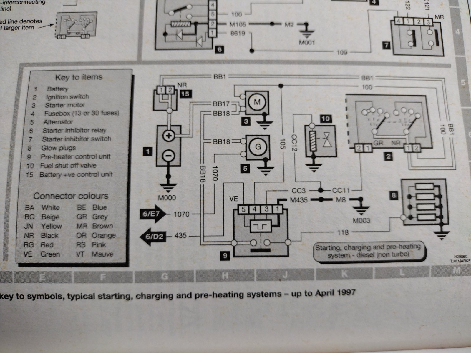

Fuel shut off valve I assume is stop solenoid
Injection pump is item 14 on this one:
This mentions "anti start" but isn't a diagram for this supplied! Pump unit is number 11
Similar on Diagram 16
again pump unit is number 11

Anti-start is definitely the keypad Matt! Thanks for those
Roger, seeing there's a connection to the oil pressure switch, check it's good. I've known pressure switches fail in both ways and if it has, it just might be inhibiting the keypad. A long shot but you never know...
A quick check is to ensure the oil warning light comes on when the ignition is initially switched on. Then try earthing the wire to the oil warning light sender...
Matt, you may have cracked it for us

However, it does need to be treated with proper consideration. As an example, the last photo shows the pump unit and states 11b is the anti-start in Diagram 16. It's not. It's 11a as per the previous picture as per Diagram 15.

Where are you seeing this oil pressure switch, Jim?CitroJim wrote: 06 Aug 2023, 04:44 Anti-start is definitely the keypad Matt! Thanks for those![]()
If you mean the last photo with the pump then that switch appears to be incorrectly marked. Luckily, Matt has tagged all the photos with Diagram numbers for ease of identification.

Roger, I've got it now. If you look at the black immobiliser plug on the pump, you see 4 wires. Keypad data, 12v supply and a signal from the oil pressure switch. The immobiliser will only work if it sees an initial earth on the oil pressure signal line. Meaning the engine is not running. Once running with oil pressure present, the immobiliser switches off because it looses its earth.
It will be off if it thinks it sees oil pressure due to a duff signal, faulty sender or bad wiring, it will be off and thus will not communicate with the keypad - hence red and green lights. Oil pressure is what effectively extinguishes the keypad lights when the engine is running. So check that oil pressure light and sender. The diagram is correct. Although in a Haynes manual it's a straight copy of the genuine article.

Please can you confirm which diagram you are actually looking at Jim. One of the ZX ones or the 306 ones?
- Posts: 55017
- x 8349
Re: ZX 1.9TD Wiring Diagram
This one Roger... Bottom right/middle... Item 11 is the pump and the four-way plug on its left-hand side is the black immobiliser plug.Rhothgar wrote: 06 Aug 2023, 14:58 Please can you confirm which diagram you are actually looking at Jim. One of the ZX ones or the 306 ones?
Big black arrow pointing left saying 'Oil Pressure Switch'
Box a within the pump (11) is the pump immobiliser unit...

The 4V MR connector to the solenoid has 4 VE wires to it (green). Of course, all coded so you have no idea where they come from.
If I knew where oil sensor was on ZX (sump presumably then I could load test the wire) and see if there is a resistance issue with it.

It's the four way BLACK connector with four black wires Roger, not the blue oneRhothgar wrote: 07 Aug 2023, 17:12 Jim
It's on the front middle of the block near the oil filter... It has one wire going to it. You can't miss it. Disconnect the wire and earth it to the block to simulate no oil pressure...Rhothgar wrote: 07 Aug 2023, 17:12 If I knew where oil sensor was on ZX (sump presumably then I could load test the wire) and see if there is a resistance issue with it.
With it and the black plug on the pump disconnected, you could check you have continuity from the send wire to the plug using your multimeter set to ohms.
