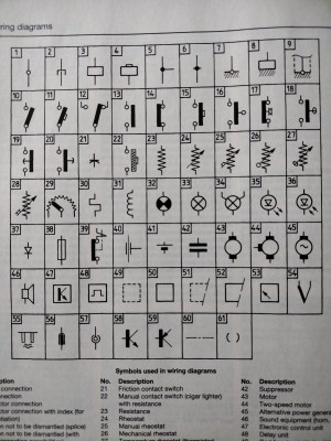

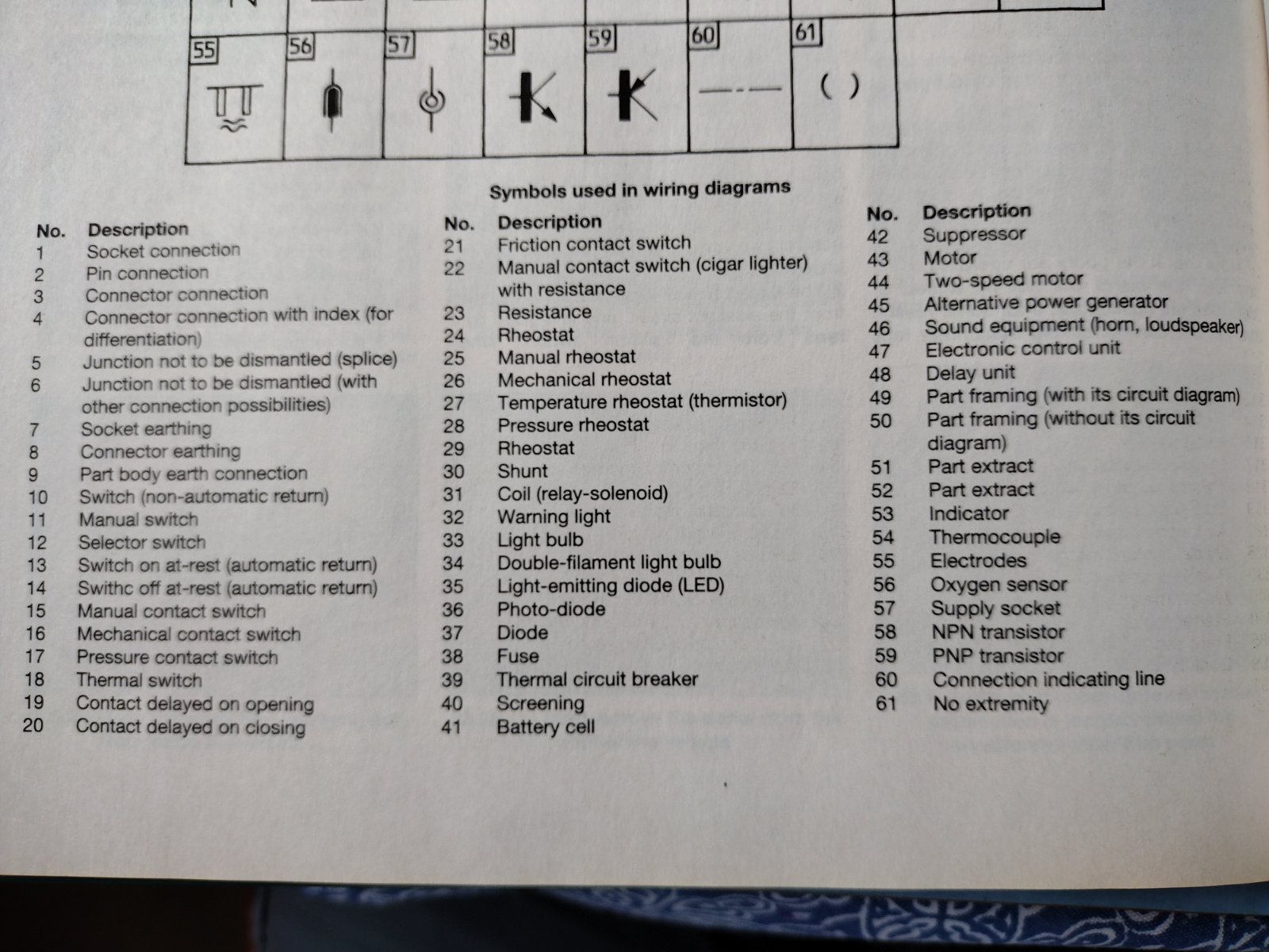

3
3
4
4

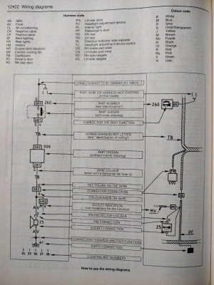

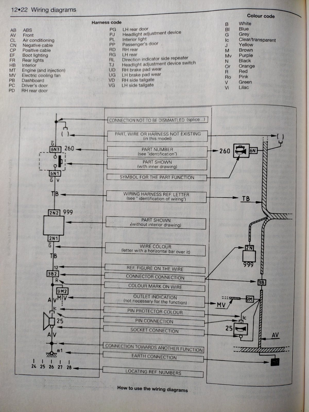

How to use
How to use

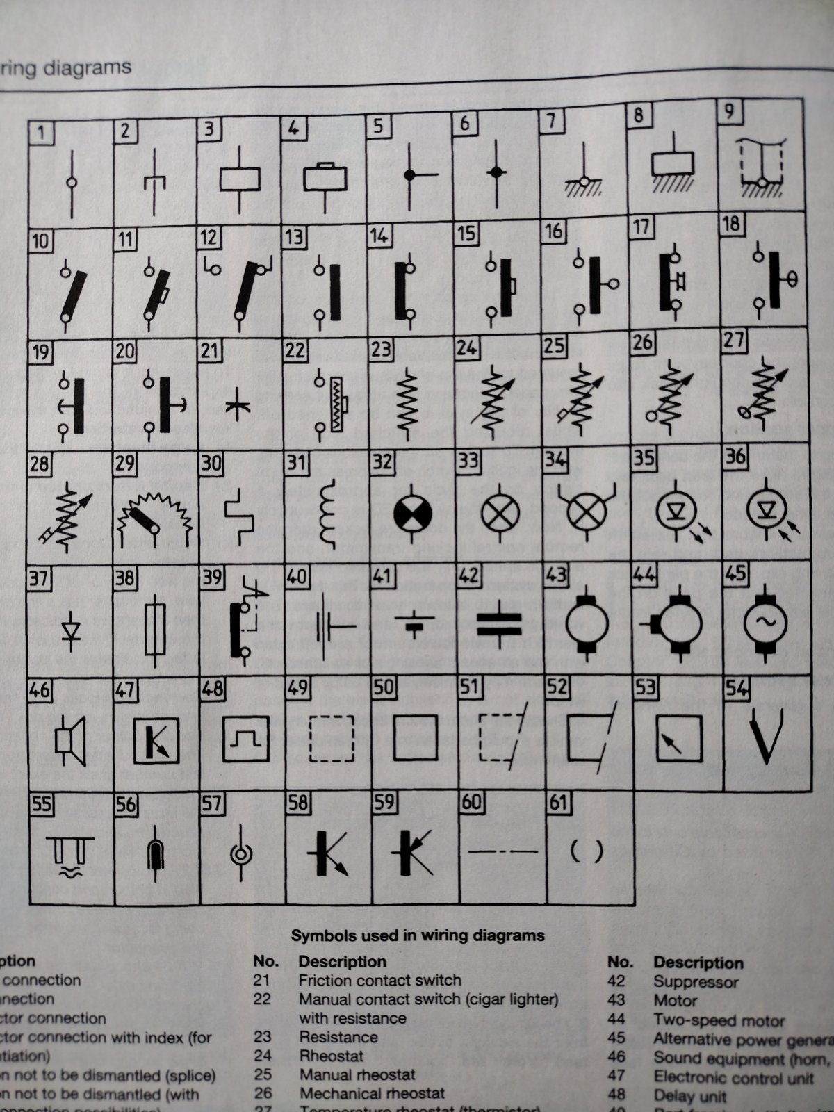

Right, a quick trawl of the actual diagrams will follow
Posts: 5306
Joined: 25 Apr 2022, 09:03
x 2337
Re: ZX 1.9TD Wiring Diagram
Unread post by MattBLancs »

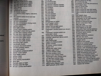

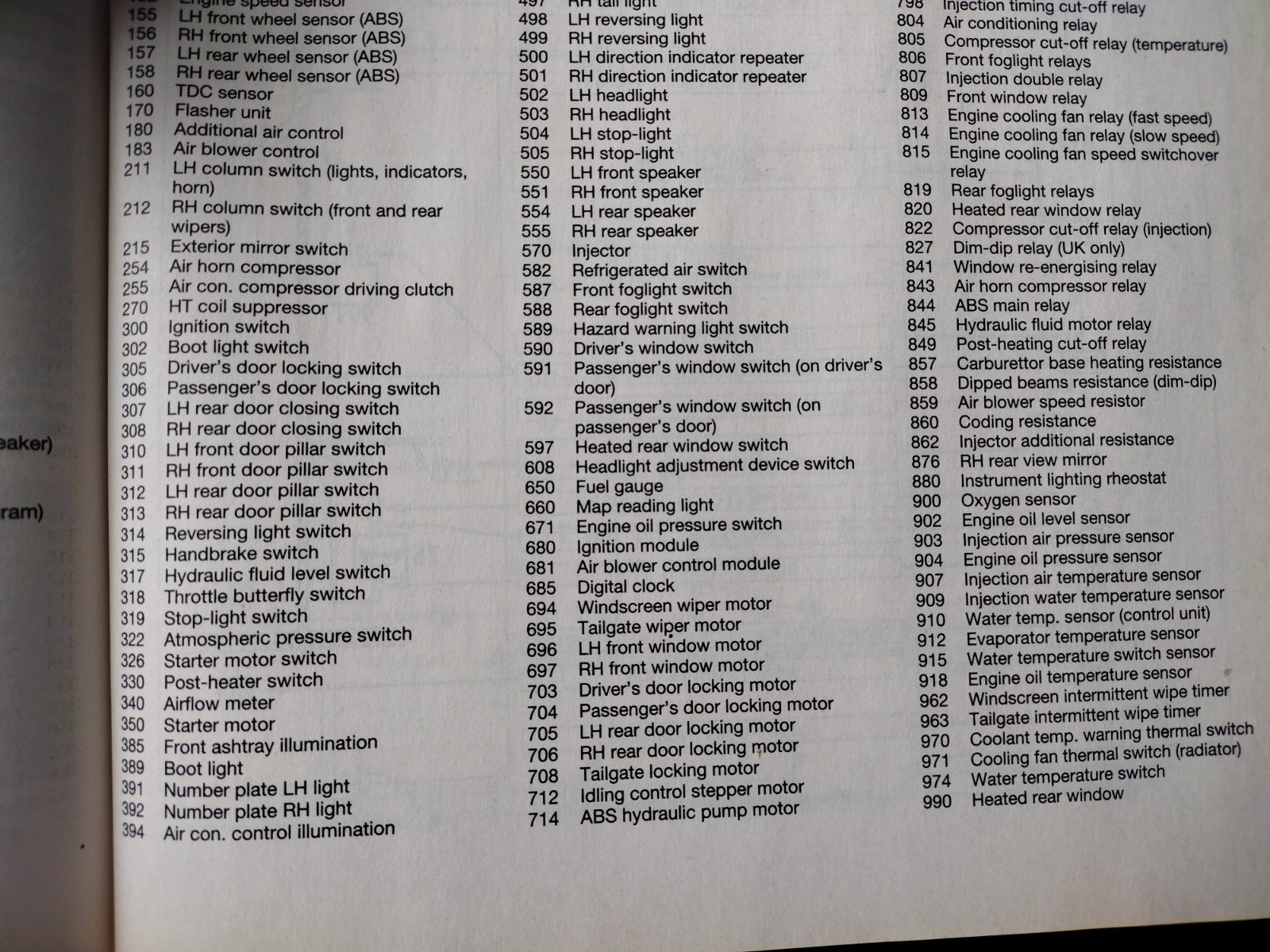

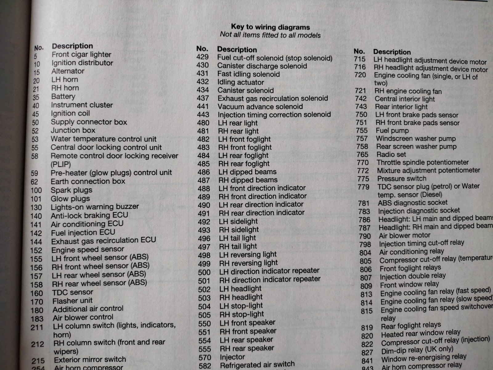

Struggling to find anything of use, number 58 (described as "remote control door locking receiver" but also as "NPN transistor" in the legend!!?!) Makes an appearance here only as far as I can see!
PLIP central on the page
If any of the numbers look of interest, give me a shout and I'll try to locate the diagram where/if(!!) they feature

MattBLancs wrote: 04 Aug 2023, 13:51 Struggling to find anything of use, number 58 (described as "remote control door locking receiver" but also as "NPN transistor" in the legend!!?!) Makes an appearance here only as far as I can see!

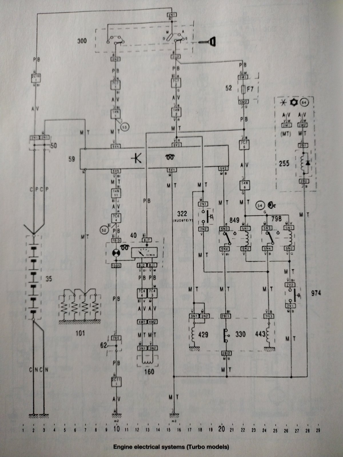

Is there any diagram with 429 on it? Look at the ignition / starter diagram perhaps please if you would be so kind?

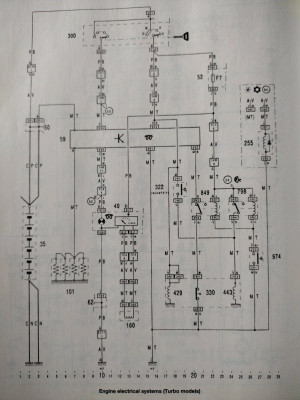

Rhothgar wrote: 04 Aug 2023, 17:49
Here you go:

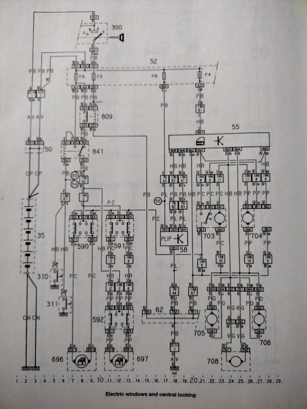

I spy a 429 (fuel cutoff solenoid)

To help extend the search for diagrams a bit, some variants of the Peugeot 306 1.9TD used the same pump and keypad immobiliser.

Central locking control 55 - middle of this sheet
