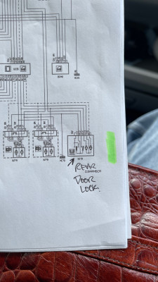

Correct, but ideally you would want to cut it near the BSI end, as if it is earthing out somewhere you will still get the warning. The closer to the BSI you cut it the less wire there is to potentially be shorted out.
Before i went down that route though have you disconnected it at the lock end and at the BSI (big black plug, cat see the numbers that well in the pic) & checked that there is no continuity to earth?

We actually got them from a garage which tried to fix the problem. I requested them from them and thankfully they were able to download them for free. I’ll attach the pictures here for what we have (just a few relevant pages.)
We haven’t found a solution for our passenger door or the sliding door yet but have been able to manually lock the back door and the drivers door. We’re just sitting ducks at the moment! Next step for us if the wire cutting doesn’t work will be dead locks for the 2 remaining doors

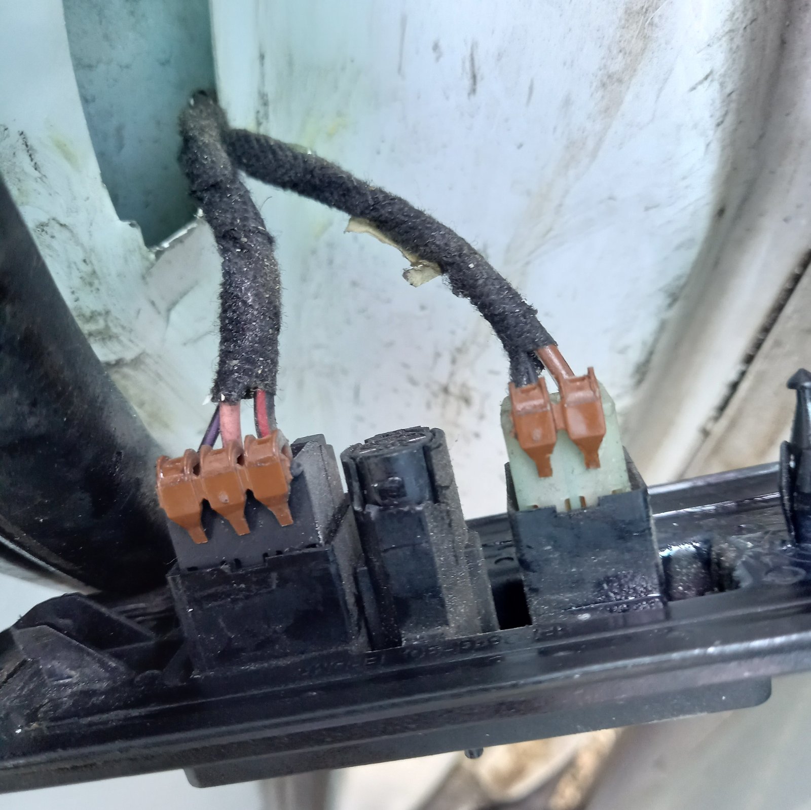

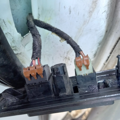

FIXED IT! Sort of.
We cut the wire labelled number 2 on the diagram which is a very tiny/thin blue and white cable which runs from the switch in the back door through to the BSI. We cut it at the drivers side loom and hey presto! Central locking works and the door sensor is now disconnected. We believe there’s a break in the wire somewhere in the loading area, potentially caused by a screw or maybe corrosion but who knows.
It’s not a permanent fix but it will do for us for now! I guess a permanent fix is to rerun some new cables to the back door but that’s a future job.
Pictures of the wire we cut for reference.

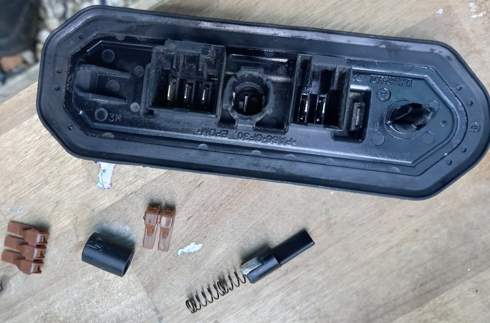

I am reviving this old thread as I had the same problem in the last couple of days of a trip to France last month - Rear Door Open warning light coming on and central locking refusing to work. However, the cause was surprisingly different to that of other reports here, on my 64-plate motorhome based on a L4H3 Citroen Relay.
I had a bike rack on the back doors with two heavy electric bikes, so assumed that was the issue, but thought to check the sliding door first. At the rear edge of the sliding door opening there is a set of contacts on a plastic moulding - 4 square metal contacts plus a small switch in the middle which is pushed in by the closure of the door. The issue was that switch, not the contacts themselves though I gave these contacts and the ones on the door itself, a good clean as they are necessary to operate the central locking for the door.
When the door is open the flat part of the switch shown in one of the pics, is kept sticking out of the centre of the plastic moulding by a spring and in this state electrical contacts on it complete a circuit inside the large plastic moulding. This tells the van's computer the door is open. When the door is closed, the flat part of the switch is - or should be - pushed in to break that circuit and the van's computer registers the door as closed. However, the bodywork of a large van flexes over time and with heat and half-way through the trip I noticed bumps would cause the Door Open light to come on. Another bump might cause it go off again but eventually it came on, stayed on and the central locking would not activate. It seems the switch was no longer being pushed in far enough to break the circuit and tell the van the door was closed.
One solution would be to put packing behind the large moulding, until by trial-and-error the closure of the door would push the switch in far enough to break the circuit. An easier solution which I used, was simply to remove the switch! That kept the circuit permanently broken so that the van's computer never registers the door as open. Obviously you must ensure you close the door securely when driving or leaving the vehicle, which is easy to see by eye. In fact my past experience was that sometimes the door would register as closed even when it was not properly closed from inside, showing a gap of a few mm at the rear edge, so it seems that the switch is inherently unreliable.
