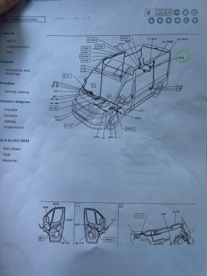

I have the exact same problem.
Where do I find the drawings for the wires please?

We actually got them from a garage which tried to fix the problem. I requested them from them and thankfully they were able to download them for free. I’ll attach the pictures here for what we have (just a few relevant pages.)
We haven’t found a solution for our passenger door or the sliding door yet but have been able to manually lock the back door and the drivers door. We’re just sitting ducks at the moment! Next step for us if the wire cutting doesn’t work will be dead locks for the 2 remaining doors

FIXED IT! Sort of.
We cut the wire labelled number 2 on the diagram which is a very tiny/thin blue and white cable which runs from the switch in the back door through to the BSI. We cut it at the drivers side loom and hey presto! Central locking works and the door sensor is now disconnected. We believe there’s a break in the wire somewhere in the loading area, potentially caused by a screw or maybe corrosion but who knows.
It’s not a permanent fix but it will do for us for now! I guess a permanent fix is to rerun some new cables to the back door but that’s a future job.
Pictures of the wire we cut for reference.
