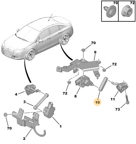

I am trying to find a knocking noise that seems to come from the back of the car, more prevalent after a few miles.
Can't see anything obvious at the moment, however, should the rear height corrector linkage, anti-roll bar to corrector move lateral by 1-2mm?

I'm not sure I follow Stu the arrow shows vertical movement which is normal practice for the linkage or am I missing something?

Sorry, should have been more accurate with my description.....GiveMeABreak wrote: 13 May 2023, 15:24 I'm not sure I follow Stu the arrow shows vertical movement which is normal practice for the linkage or am I missing something?
When I hold it, between my fingers, it moves 1-2mm up and down without the corrector or anti roll bar moving, do the end cups wear?
As I said I trying to narrow down a knocking noise and this is the only thing I can find that's loose. .

The angular pickup (vertical item in your photo) connects between the sensor and the Anti-Rollbar Lever via snap in ball joints. To my knowledge these should be relatively compact and tight fitting, not loose.
Item (10) (the angular pickup link), part: 527381, £7.68 hasn't been changed, but (11) (the anti roll bar lever) has been superseded with part: 1687269980, £304.74
So may be worth a punt on the angular pick up as that has the plastic fixing that encases the ball joints at each end and hopefully will be a lot tighter on a new one!

Cheers Marc, I will get in touch with my local Citroën garage and order one Monday.
Hopefully they are still available
and it turns out this is where my knocking comes from

No worries - they are still available Stu.

Marc thanks for the diagram..
