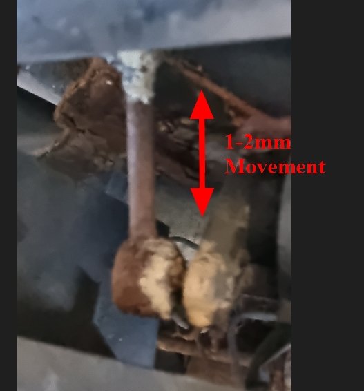

I am trying to find a knocking noise that seems to come from the back of the car, more prevalent after a few miles.
Can't see anything obvious at the moment, however, should the rear height corrector linkage, anti-roll bar to corrector move lateral by 1-2mm?
Cheers

I'm not sure I follow Stu the arrow shows vertical movement which is normal practice for the linkage or am I missing something?

Sorry, should have been more accurate with my description.....GiveMeABreak wrote: 13 May 2023, 15:24 I'm not sure I follow Stu the arrow shows vertical movement which is normal practice for the linkage or am I missing something?
When I hold it, between my fingers, it moves 1-2mm up and down without the corrector or anti roll bar moving, do the end cups wear?
As I said I trying to narrow down a knocking noise and this is the only thing I can find that's loose. .
Cheers
Stu
- x 6954
Re: Rear Hieght Corrector Linkage
The angular pickup (vertical item in your photo) connects between the sensor and the Anti-Rollbar Lever via snap in ball joints. To my knowledge these should be relatively compact and tight fitting, not loose.
Item (10) (the angular pickup link), part: 527381, £7.68 hasn't been changed, but (11) (the anti roll bar lever) has been superseded with part: 1687269980, £304.74
So may be worth a punt on the angular pick up as that has the plastic fixing that encases the ball joints at each end and hopefully will be a lot tighter on a new one!

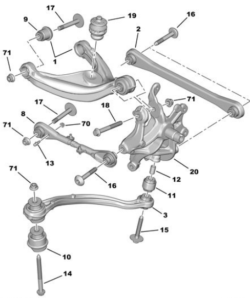

Don't forget that the rear suspension has a multi-link setup and we mostly tend to focus on the front - but the rear has multiple bushings and mountings:

Marc thanks for the diagram..
