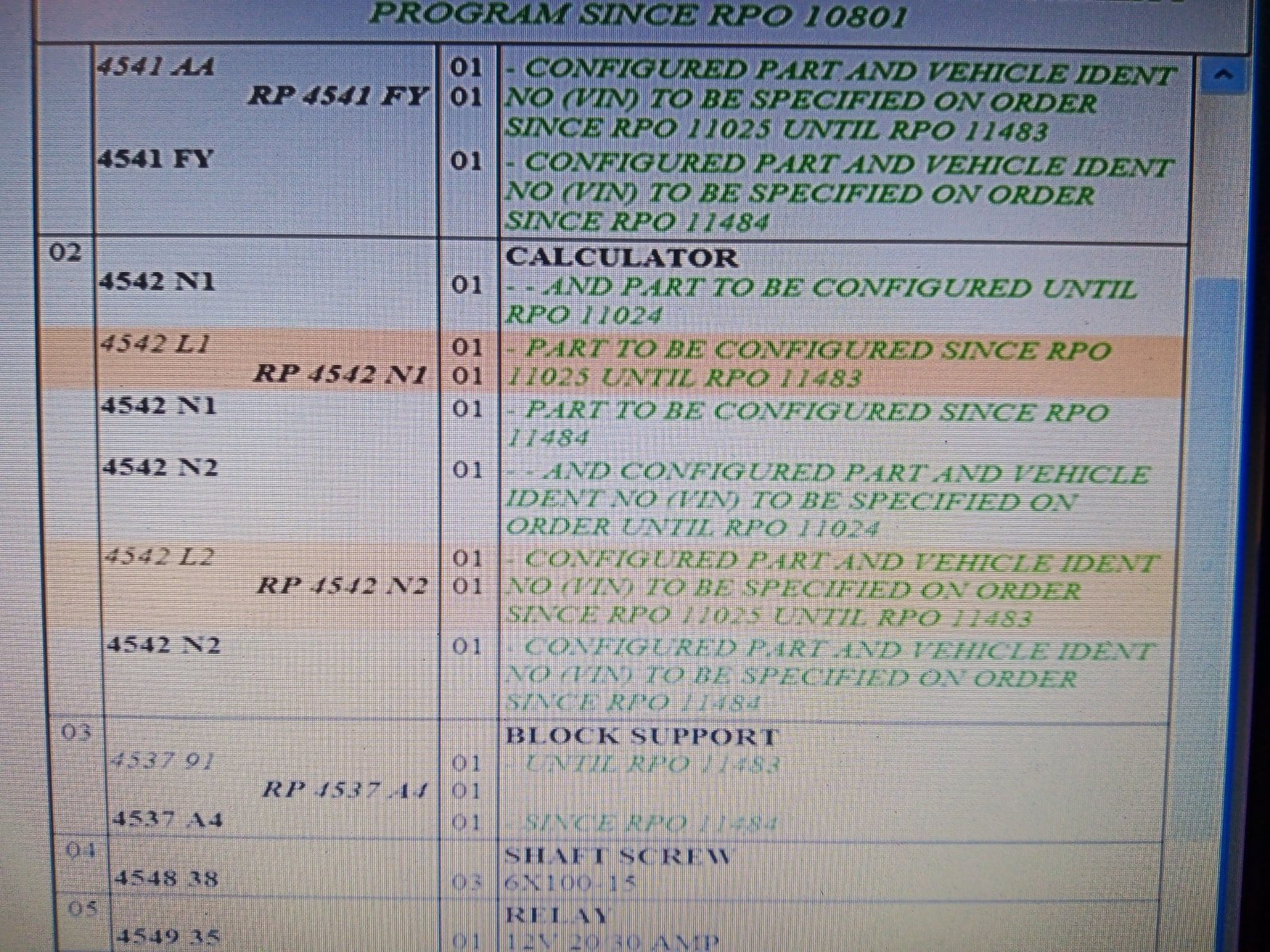

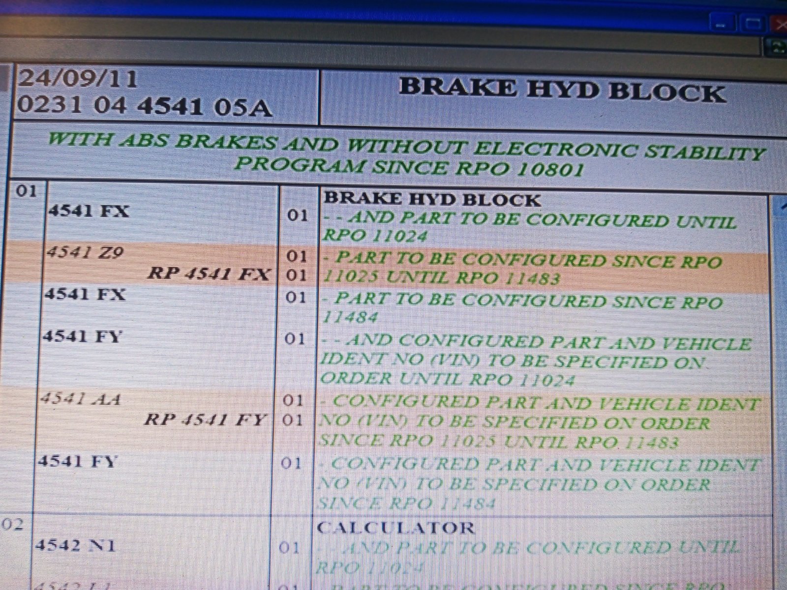

part numbers from sedre Citroen manual using my rpo number.

You haven't supplied your VIN, so I am going off a C3 II based on the year from your first post and what you have shown above is from the old off-line data that is well out of date (over 11 years) and some of those parts are not even available now! We only use live data from Citroen here and use your VIN to ensure correct parts.
If you are confident you have what you want then there's nothing further we can do to assist.

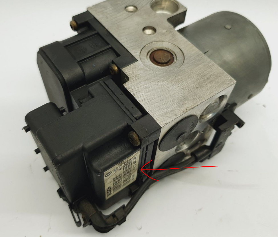

There's nothing you can do regarding repairing it to be honest and opening it up won't provide any detail on the part number. The hardware, software versions and the part number (Manufacturer part not PSA Part number) would of been on the label of the unit. If that's missing then you have no info on the part fitted.

it's ok, I've got all the numbers, nevermind about identifying the ECU I'll just have to cross my fingers and hope..
(that's a totally different unit tho, it's the ATE MK70)

I know - I was just using it as an example to show the label.....
