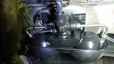

Re: C5 X7 rear hydraulic pipe-hose stainless substitute
Hi Jay,
I hope that we are not stepping on each other's toes in our projects. But I think that there will be probably more than one solution of saving our cars for the future. We are trying to go the original way with few modifications.
please see attached:
Pipe from AL piece to front HP pum is not a problem. Also pipe from AL piece to firmness regulator is not a problem (i dont have it here, but you can visualize it on photo
), but I still have only version without rubber hose part (it works the same for me, but maybe if there will be a time...)
During next days I plan to prepare drawings for the aluminium piece to made it from stainless steel. If you see those 2 tiny shiny pieces betwen AL piece and black regulator - they are also stainless...
I think that our goal is the same, maybe the ways are different.
Svod
Svod
