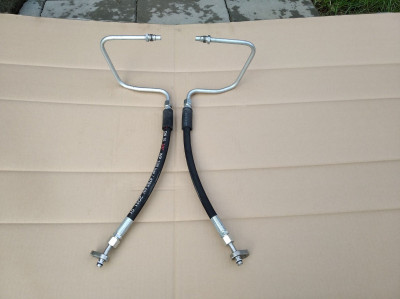

Two years ago I was forced to change rear hydraulic pipes on my ’09 x7 2.2HDi cause one of them leaks. Whereas the pipes was unavailable to buy here I decided to create substitute from original. I was working on it with my colleague. We tested almost 10 pairs during last year and half and we can now manufacture them for C5 X7
Citroen numbers for them are:
- 5270VG C5 X7 right
- 5270VF C5 X7 left
Tubes are similar to original, except they are not made form zinc steel, but from stainless to ensure long life. Next difference is that they are separable to 3 pcs (1st one is stainless steel pipe, 2nd one is rubber hose, 3rd one is stainless upper part which is connected to rear hydraulic piston). Rubber hose is certified for use with more than 300 Bar pressure, but even if somewhere in future hose starts to leak, it is possible to change only the hose. Not whole pipe.
We want to make first larger batch and to specify the price I’m curious if some of you want to buy those for your C’s.
Let me know if you are interested or if you have any questions.
- Actual 1:1 original version
- First version with shorter stainless tubes
C5 X7 rear hydraulic pipe-hose stainless substitute

There are two questions I want to ask. First, is the rubber hose suitable for use with the LDS fluid? Second, is there any possibility that you will make pipework for the earlier C5s?

Rubber hose is suitable for wide range of hydraulic fluids. It is used in heavy industry hydraulic machines. Also I've already driven 40k km with them with no problem (since 02/2021).

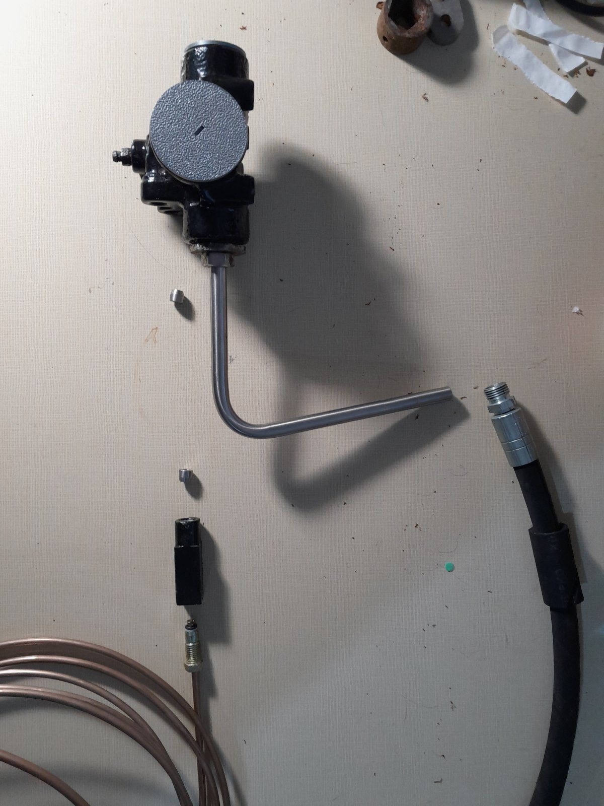

I hope that we are not stepping on each other's toes in our projects. But I think that there will be probably more than one solution of saving our cars for the future. We are trying to go the original way with few modifications.
please see attached:
Pipe from AL piece to front HP pum is not a problem. Also pipe from AL piece to firmness regulator is not a problem (i dont have it here, but you can visualize it on photo
), but I still have only version without rubber hose part (it works the same for me, but maybe if there will be a time...)
During next days I plan to prepare drawings for the aluminium piece to made it from stainless steel. If you see those 2 tiny shiny pieces betwen AL piece and black regulator - they are also stainless...
I think that our goal is the same, maybe the ways are different.
