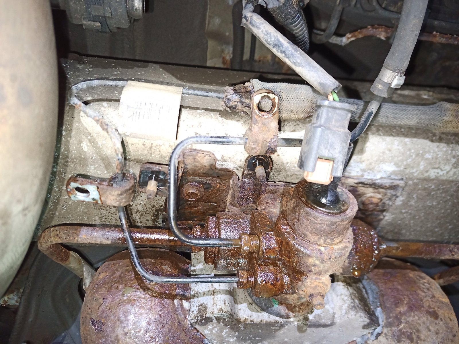

So... The original pipe was originally coated, the real culprit isn't road spray, it's galvanic corrosion literally stemming from that ALUMINIUM union. There's not really a need to coat the new pipes I'm developing as I'm going to ditch that aluminium union, replace that entire pipeline with galvanically compatible materials.
However, as I love to over-engineer things, I see no reason not to offer customers the option to sleeve the new pipework with heatshrink tubing, so I'll go explore what is the highest ratio heatshrink tubing I can get my hands on, as in a 4:1 tubing would be 10mm ID and shrink down to ~2.5mm ID. I'll see what I can find and get back to you.

My C5 is in the exact same state and I'm praying I won't have to touch it. They look horrendous but when I changed my front to rear pipe after the leak the union broke with no fuss.
These regulators will be like hen's teeth soon. I look at the securing nuts for the regulator and they look more like blobs of rust rather than nuts.
Just replaced the rear height sensor and had the same problem with the support bracket. Yet a few inches away the triangle pyramid nuts were in excellent condition.

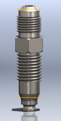

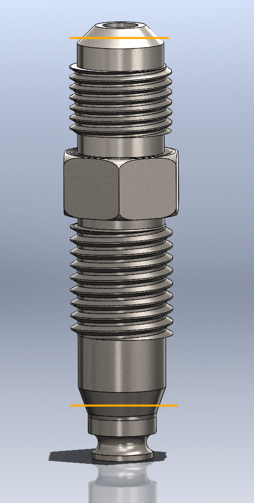

Came up with a new approach for these blerry fittings, rather than try and piece three things together and end up struggling with the width of the flare at the bottom of the pipe, and struggling even more string to shoehorn an oring in there,I came up with the idea of making a nipple that's an exact copy of the citroen gubbins on oneside to screw into the port, and on the other side it's got a m10x1 brake pipe nipple on it. Here is a screenshot:
The LDS gubbins at the bottom is an amalgamation of the tube end, the o-ring, the washer, the cone and the tube nut in one body, the top end is modelled off of a conventional brake pipe fitting, m10x1.0mm male male joiner, like this:
My machinist is excellent, so on my fittings, you won't have the striations on the tapered mating face that can be seen in the picture above.
This new decision to come out to an m10 flare would give you options for how to fit them, you could either use a female/female joiner on the nipple, like this:
...and run in with a conventional male pipe nut and a single 45° flare, but best with a 45° double flare; or you could use it as it's designed to work; with a female brake pipe nut with the 45° flare on the tubing which would keep the overall fitting shorter, but might be less tolerant of imperfectly flared pipes...
In the first picture, the screenshot from my CAD, repeated above, you can see the obvious o-ring groove at the bottom, I'm debating sticking a couple of extra o-rings on the nipple at the points denoted with the yellow line. Basically, I'd put another o-ring on the LDS end on the chamfered face as a secondary seal, and also one on the cone in the m10x1.0 brake fitting to help seal the flared brake-pipe-styled tubing end against the cone. I've seen this sort of thing for JIC fittings designed to be used with flared tubing:
Do you guys want an o-ring in that location on the flarepipe mating cone?
Technically if we can get these nipples to seal in the LDS end, it'd be on whoever is flaring the "brake pipes" to do the flares well well to get a seal, but I'm trying make sure this is a pain free solution for y'all to work with, so was considering the extra o-ring to make it easier for y'all to get a seal on it. So what do you think, should I put an o-ring on the brake fitting style cone?

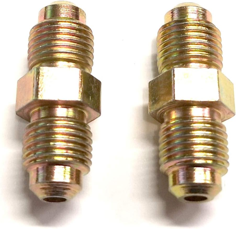

I've not seen an O-ring in a position like on the JIC fittings pictured, what cross section are the O-rings pictured?, as look tiny! I'd be concerned it could be more trouble than it's worth.
The standard Citroen setup I presume allows slip between where the O-rings are and the threaded second, so eliminating that potential is only thing I would worry about with your proposed one piece fitting.
I'm not sure if the lack of slip would give a hard time for the O-ring on assembly (but nowt a dab of red rubber grease wouldn't eliminate?) And/Or else increase the torque required to break the fitting loose from whatever it has been screwed into for disassembly maybe years later.
However, if installing one of your proposed fittings, you could split it at the M10x1.0 instead. So no need to disturb the Citroen fitting replacement once installed.
Given that, would it be better to aim to add a thread locking / sealant at the original connection and do away with the considerations of extra O-rings?

Hi Jay, firstly very good design and better to think out loud it helps to solve problems and purge any misgivings. I agreed with Matt the idea of a secondary seal on a threaded fitting would probably result in complications such as failure by damaging the o-ring during the the threading in process. The only suggestion I would have is you could bench test with and without. To me your at the prototype phase and need to determine efficacy. I hope it helps.
