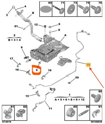

Hey! I was wondering if someone could help please as I'm needing to drain my 2015 308 adblue tank but can't find anywhere to say how. Any ideas please?

There is a little drain plug on the bottom of the tank (number 5 in the picture)
There is a little torx screw (T-20 from memory) holding the plug in, once you undo this just twit the plug & pull.
Leave the filler cap on initially to make it empty more controlled, Just be ready if you have the filler cap removed it drains out fast.

I have a 5008 mk2 and have poured screen wash in the Adblue tank, not started and ignition hasn't been on.. is there a drain hole on the 5008 ?

It appears to, front corner opposite side to the filler neck. Make sure to wash it out well with distilled water before refilling.
