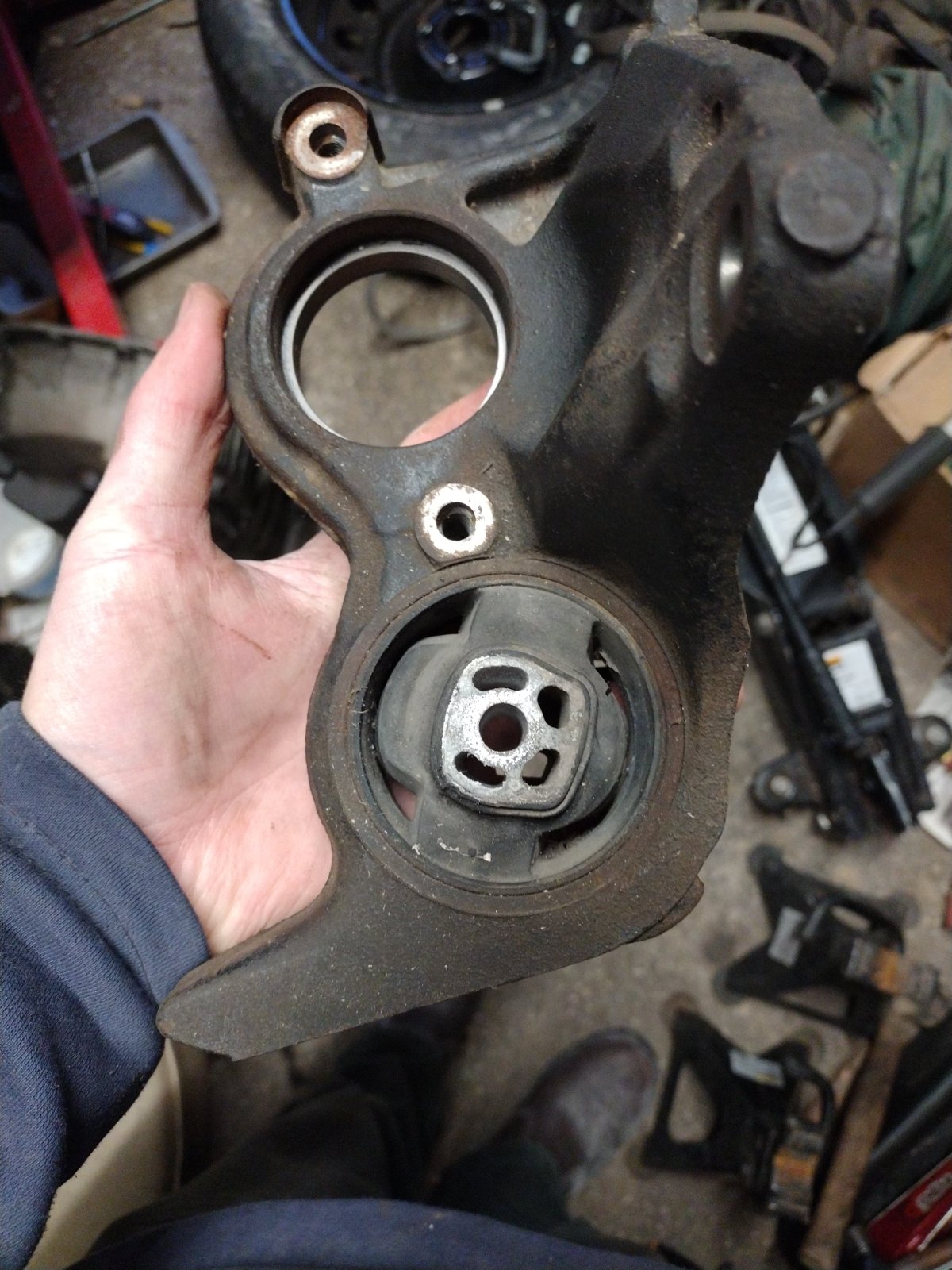

MattBLancs wrote: 05 Feb 2023, 17:02 Here's a picture of a 307 2.0 petrol lower mount. Looks similar to me Image
Cool , when i saw that gap i flipped !

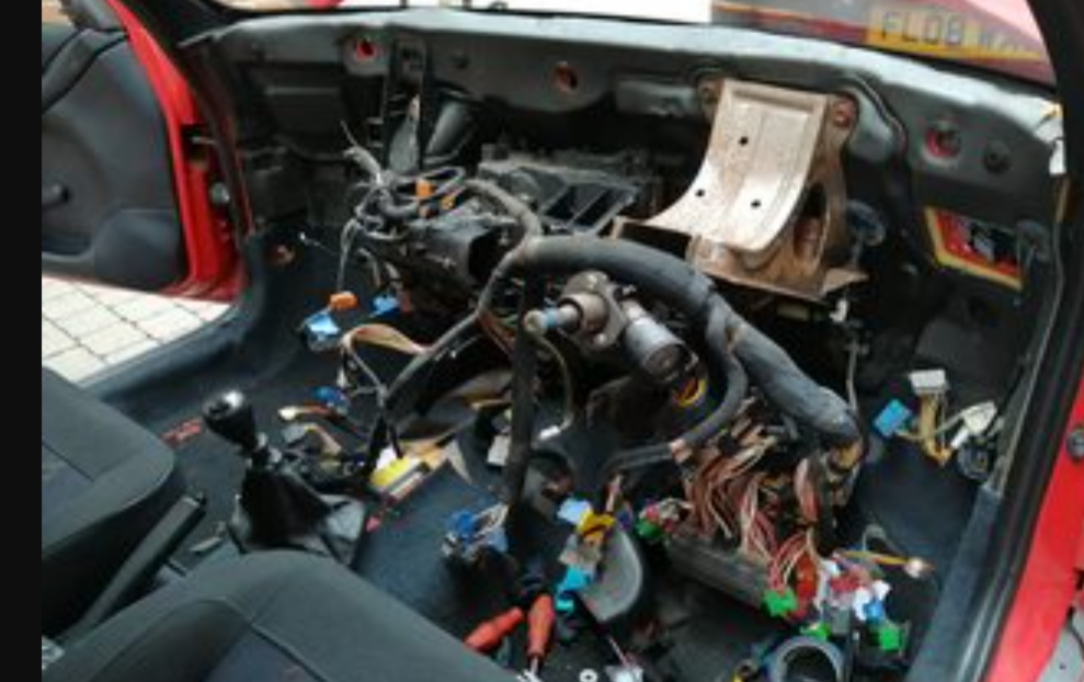

Here Matt have a look
:-D
Posts: 5311
Joined: 25 Apr 2022, 09:03
x 2341
Re: Engine mount , this looks iffy
Unread post by MattBLancs »
Huskyxantia wrote: 05 Feb 2023, 19:53 Here Matt have a look
Brilliant! Wow, remarkably straight forward!
This is same job in a 306
http://www.306gti6.com/forum/showthread.php?id=168346
(Not my picture, but have read up on this previously)
So you can understand why I was filled with dread! :-D
I'll wait for autodoc's latest one off never to be repeated though actually very similar to last Monday sale tomorrow and likely get a matrix ordered.

Matt, I'm a 50 yr old man with an autistic brain, diagnosed 4 yr ago answered why i was always in trouble at school and growing up in general, i find if you think about a job on a car to much or to hard it jumbles up the reality of how straight forwards some jobs are . Id like to follow your task if you manage to photo diary what you do and post on here, that a be great .

A long time ago I worked with a bloke with a 306 who changed the heater matrix.
The matrix was the easy bit, dismantling everything to get to it then reassembling it all took three days.
Forewarned I let the garage do my Xantia matrix, well worth the £180 it cost.
If you are concerned about clogging, then a shot of Forté cooling system flush may be called for. Alternatively there is Liquimolly that Chris (White Exec) swears by.

I've given that video a watch and will change matrix. I also have a thermostat / temperature sensor/ coolant manifold plastic lump to fit, so will do a coolant change (as it's been in more that 5 years I think) and the two jobs together. If the car will tolerate light use till the weather puts another few degrees on preferably!
To be honest it's been loosing coolant very, very slowly for a while, so this is good news as been unable to find any leak evidence, just a drop in level.
Good news, and also something else on the job list, hey ho!

Hell Razor5543 wrote: 05 Feb 2023, 21:38 I recall that if you were fitting a replacement Valeo heater matrix you had to also use Forté Stop Leak (to fill any micro leaks at the fittings) for them to consider their warranty to be valid.
Yes, you are quite right James :D I last used it in my Saxo when I could just smell a slight whiff of coolant when the heater was on full hot and it's been perfect ever since...
As a veteran of many Xantia heater matrixes, it's just a long, tedious job taking all the dash apart and putting it all back together again... Not technically difficult at all but you do need to be well organised and methodical to ensure all goes back together exactly as it came apart and no screws are left over at the end ;)
Give yourself plenty of time and enlist some help as the dash itself is surprisingly heavy and awkward to manoeuvre single-handed..
Just to add as a late confirmation, your lower mount looks in good, serviceable condition to my eye Husky... They are designed like that deliberately to have more 'give' in one axis and less in the other...

Thanks Jim . When i saw the size of the gap from part to car body my gut turned over lol
