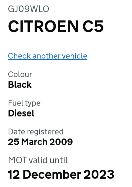

Excellent news on the MoT Matt
She'll be fine on the trip

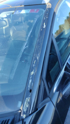

Yes, it made it up to Cumbria without issue.
Well, almost!
Got on the motorway and passenger side windscreen trim decided to announce failure of its adhesive by dancing on and off the screen! A gentle removal in the services took this off and into the car.
Then, about 50 miles later another big surprise, went to clear the screen and saw driver's side wiper fly off, up the screen over the car and away!
Only about 6 months old (and next to no miles covered given the fun I've had with it) so more that a touch disappointing with that eBay purchase.
Off to the nearest Eurocarparts branch tomorrow morning on my way home. So long as don't live up to their "Eurowrongparts" reputation!

I believe that windscreen trim was an early recall on these. Can't imagine Citroen would be interested in honouring the recall now though
