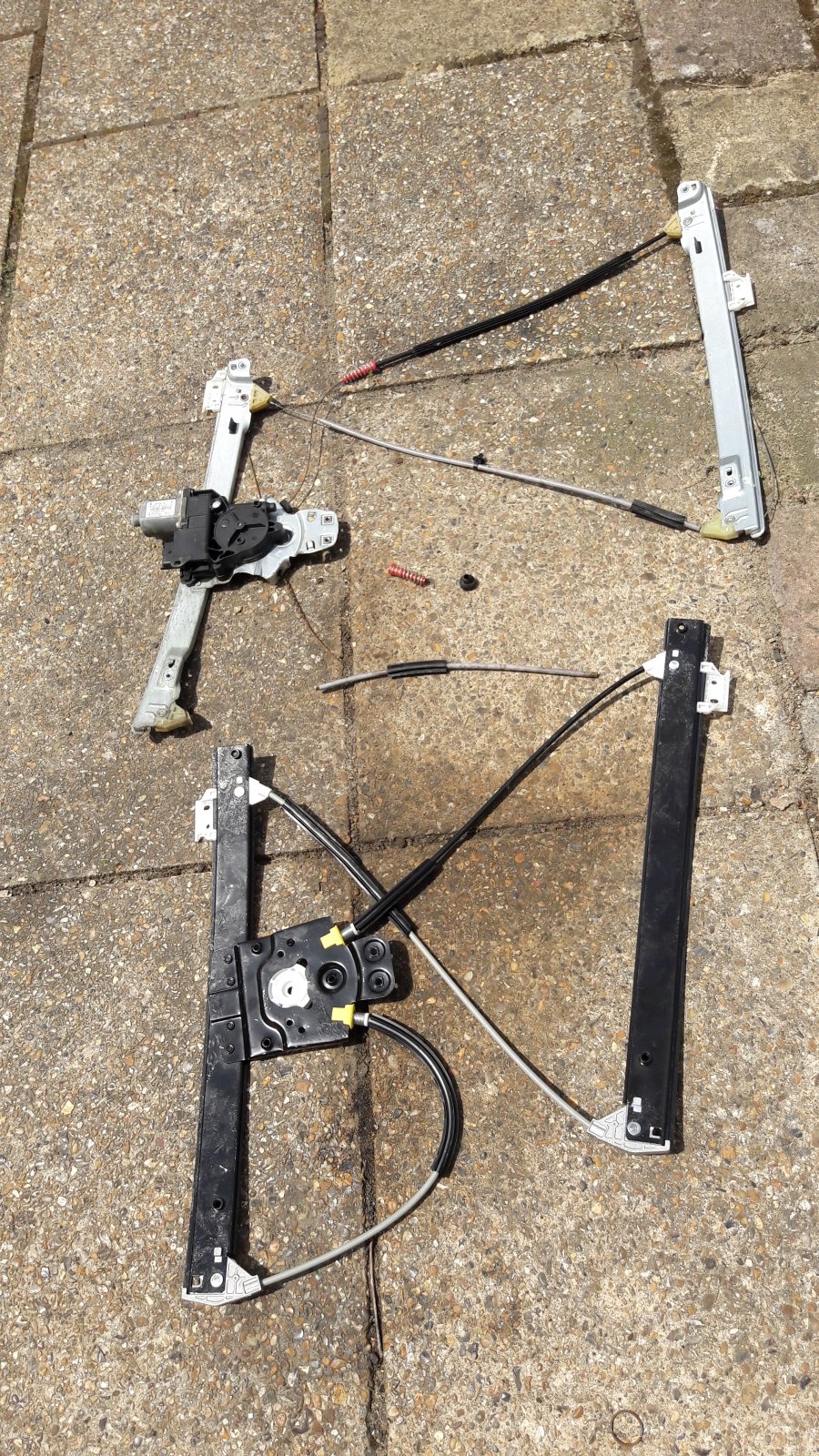

....this from my 'How To' on the forum.
bobins wrote: 18 Jun 2017, 16:51
Old frame above, new frame below.

Mine has a locating hook beside each of the bolts that hold the frame rails into the door. The parts I bought dont.
