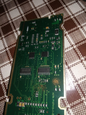

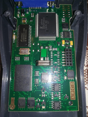

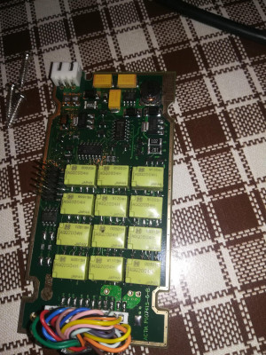

This is the chip set in my VCI

Guys, if you are missing the hardware like the optocouplers and the 10k resistor and other bits, it probably won't work on later vehicles regardless of cable you are using.

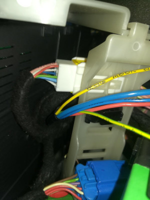

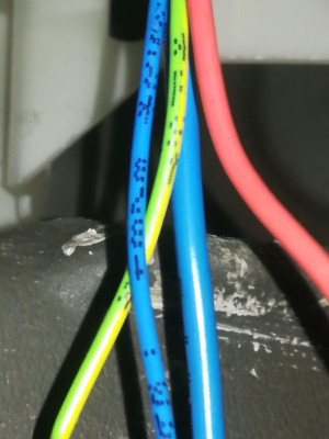

I just found the last picture behind the BSI I was getting ready to change the Cabin Filter and copped them hanging down.
They are coming from the middle of the loom going to the rear of BSI. I tried googling the codes on the side of the wires I can see but I didnt get any hits. does anyone have any Idea what these are.
The code on the plain yellow wire is A26 3007 2878, the rest I cant get good enough of a picture to read

No idea but I think this fella is asking the same questiondarbuck wrote: 26 Nov 2022, 16:06 I just found the last picture behind the BSI I was getting ready to change the Cabin Filter and copped them hanging down.They are coming from the middle of the loom going to the rear of BSI. I tried googling the codes on the side of the wires I can see but I didnt get any hits. does anyone have any Idea what these are.

Ok thanks Ross I found a comment on it and translated it. Apparently the wired are a redundant set for something else. So panic over
