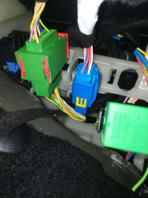

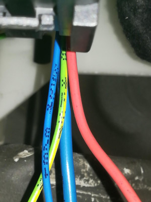

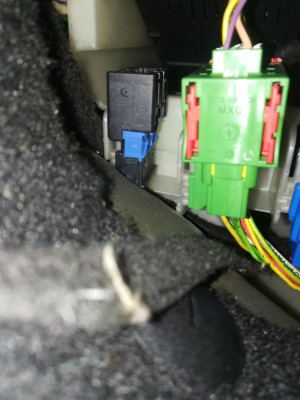

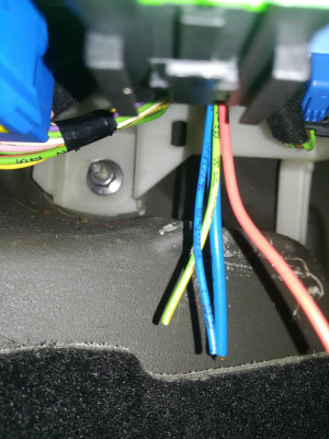

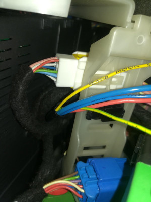

I just found the last picture behind the BSI I was getting ready to change the Cabin Filter and copped them hanging down.
They are coming from the middle of the loom going to the rear of BSI. I tried googling the codes on the side of the wires I can see but I didnt get any hits. does anyone have any Idea what these are.
The code on the plain yellow wire is A26 3007 2878, the rest I cant get good enough of a picture to read

No idea but I think this fella is asking the same questiondarbuck wrote: 26 Nov 2022, 16:06 I just found the last picture behind the BSI I was getting ready to change the Cabin Filter and copped them hanging down.They are coming from the middle of the loom going to the rear of BSI. I tried googling the codes on the side of the wires I can see but I didnt get any hits. does anyone have any Idea what these are.

Re: Interface firmware
Screenshot from the youtube video - you'll see it just after the six minute 12 second mark
Ok thanks Ross I found a comment on it and translated it. Apparently the wired are a redundant set for something else. So panic over
