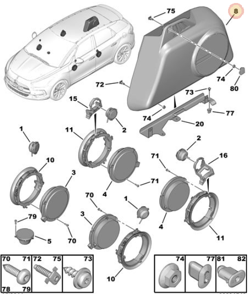

If you have the Connected Nav system, then the amplifier is incorporated into the loudspeaker unit (bass box) which is located in the rear right-hand side of the inner boot area. There should be 3 bolts (the top bot is covered). Once carefully removed, the connections are on the inner side, so be careful not to pull it away too much before unclipping the connections.

(8) Loudspeaker Deep Tone Amplifier, part: 1606864280, £832.18
All prices are UK VAT inclusive and ordered from Citroen directly.
Let's just hope it's not the amp, but a proper diagnostic with Diagbox should allow the Audio system to be checked as there are tests available. It may be a loose connection. Have you undertaken any work or fitted anything recently?

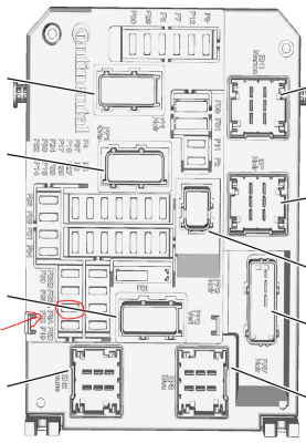

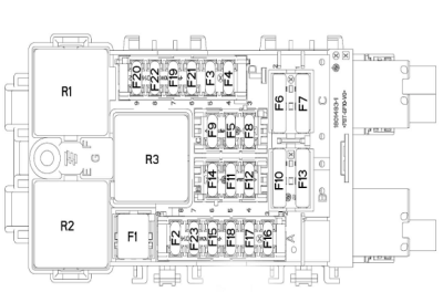

I don't have the wiring for the later DS5 with certain updated options, but it may be worth checking out the following fuses.
On the older equipment with RT6 unit and amplifier, there were a couple of fuse locations:
In the BSI, Fuse F32 (amplifier - radio - telematics - head-up display screen), which I have circled in red below:
In the Cabin Fuse box (BFH3, Fuse F12) below:
But, like I say, they may have changed options with the later Connected Nav system. But may be worth a check.
