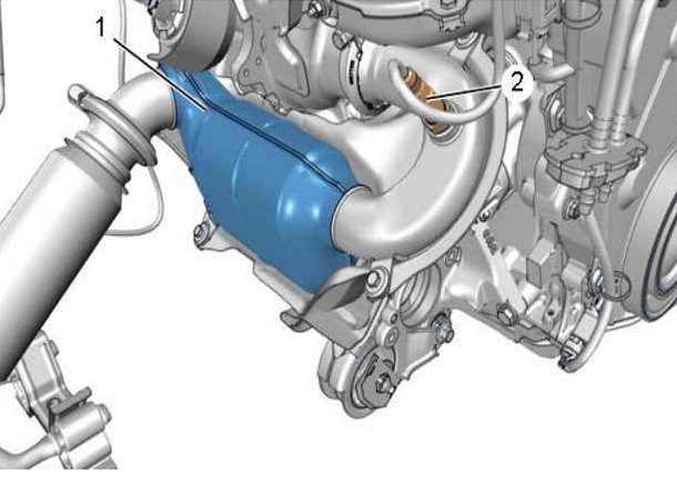

Hi can anyone tell me which sensor or location is an 02 sensor bank 1 sensor 1
error codes P2231 and P0131 occational limp mode but an obd2 can clear and returns to normal. DPF doesn't appear to be blocked. no black smoke, no loss of power or reduction in fuel economy
want to get the right one changed instead of garage hit and miss.
2012 Peugeot 3008 2.0 hdi

Here are the fault code descriptors for you.
If you are referring specifically to the Oxygen sensor, there is only one on this engine, shown at (2):
Fault Code:
Description of Fault:P2231 Oxygen sensor: Integrated slave circuit of the sensor faulty.
Electrical fault in the oxygen sensor detected for 5 seconds.
Conditions for Fault to clear: Driving with the engine hot for 5 minutes.
Downgrade Modes whilst Fault is active: -
Symptoms: Excessive fuel consumption
Suspect Areas:
  • Oxygen sensor
  • Connectors
  • Electrical harness
Fault Code: P0131
Description of Fault: Oxygen sensor: Short circuit to earth. Voltage less than 0,5 V for 100 ms.
Symptoms: Slightly higher fuel consumption
Suspect Areas:
  • Connectors
  • Oxygen sensor
  • Engine ECU
If you need official part numbers, and you can't already find the info you need on the Forum, we do ask for a membership upgrade for official parts data as we are in turn charged for this. It will cover you for future parts requests for up to 2 years, so excellent value.

thank you very much Marc, appreciate your help. and how did i know it was going to be at the back of the engine, just typical. guess i either bite the bullet at the garage or scap the dam thing
mind you it does very well on fuel, normall 51 mpg
Posts: 42019
x 6955
Re: faulty sensor
It's only 41CM long, so should be easy enough to replace once you get to it and there's no programming or initialisation for the new sensor to worry about either.

Thank you for the heads up marc. I've investigated where it should be located from your picture. I found it, think i might have to take it to my garage as there is no way we can do it. I struggle under the car this will have to be a ramp job. Just hope they are kind as the pension is pretty stretched now and the part is 97 +vat.
