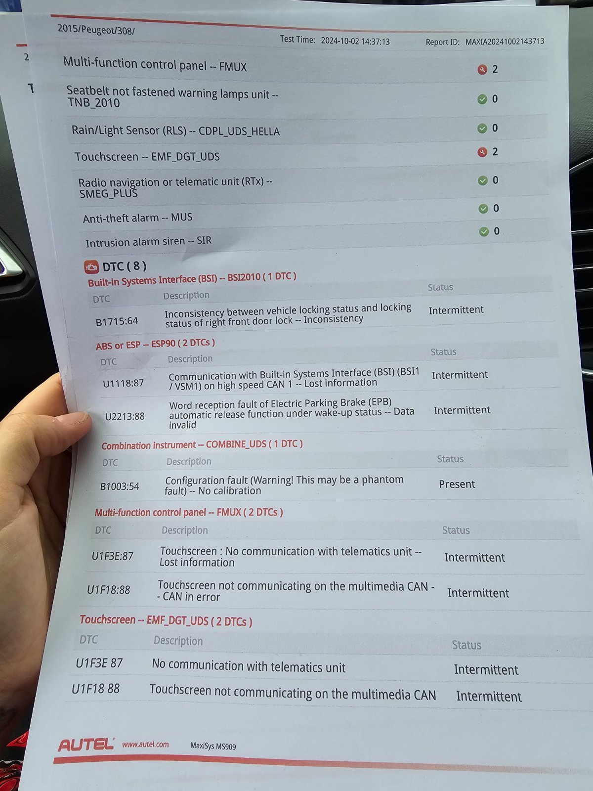

Update:
Swapped siren for replacement second hand unit. No difference noticable on locking the car or status shown for the alarm on Diagbox.
For completeness all fault codes are given below. Is there an easy way of printing of these from Diagbox 9.68 on a v. machine?
Will add more details in next posts as the post editor keeps losing data if I take too long.

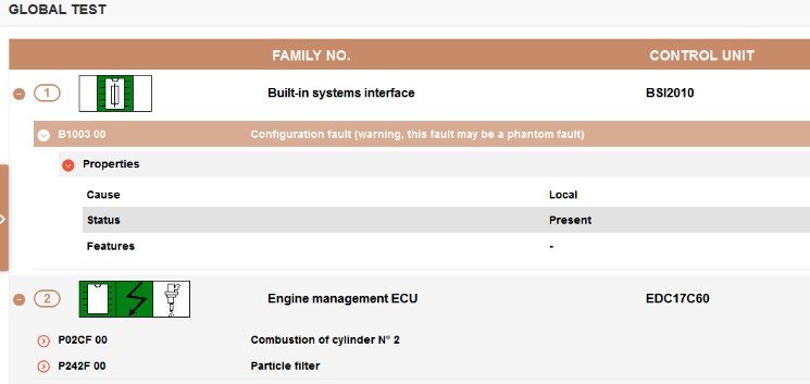

Re: 2015 C4 Picasso alarm/BSI problem
Alarm status:

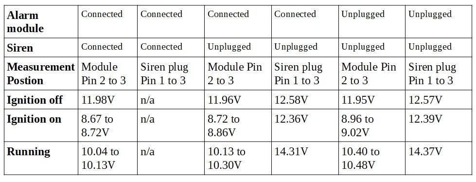

One more observation as I had already measure these:
Having measured a strange voltage on the alarm module (8.6V) pin 2 to 3, I thought that I would see if the new one was any different. It wasn't, but I'm even more baffled by the results: Notes:
I can't measure the voltage at the siren plug when the siren is plugged in.
All the results from the siren plug were steady when measured by a DVM. When the ignition was on or engine running, the voltage measured on the alarm module was varying slightly so the range of voltage is recorded.
It is very strange as according the the wiring diagram the two points are connected together.

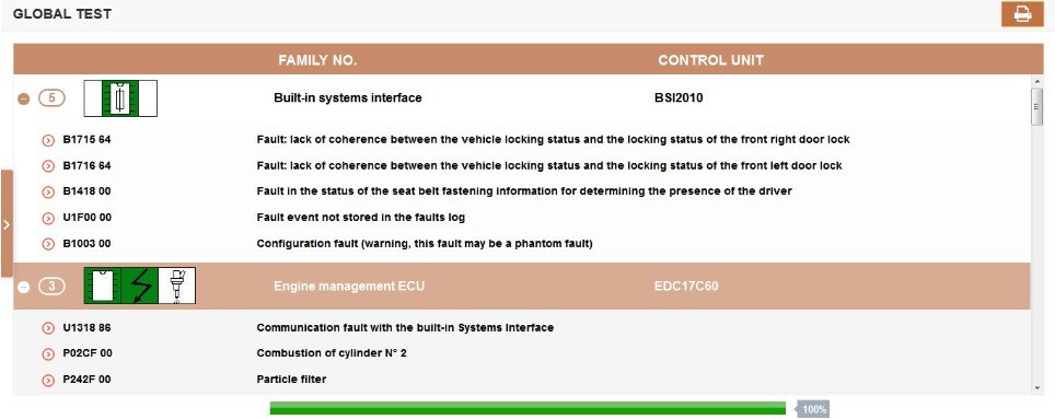

I really think any work on the alarm is a lost cause whilst you have these other more important faults - it's really not going to make any difference with the other issues as I can see.
My remaining thoughts on this based on fault codes below:
Other faults for which I don't have full info:

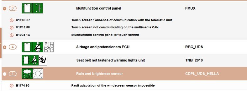

U1F3E 87: Touch screen: Absence of communication with the telematic unit
U1F18 88: Touch screen not communicating on the multimedia CAN
B1004 1C: Multifunction control panel or touch screen: Touch screen: Voltage outside range
B1137 01: Right dipped beam fault: Short circuit to positive or short circuit to earth or open circuit
B1138 01: Left dipped beam fault: Short circuit to positive or short circuit to earth or open circuit
Note For fault: B1003 00, your vehicle may not have all the functions listed - this was from another vehicle, just to ge the cause, but the suspect areas are the same - the BSI Configuration.
- Either the BSI has become corrupted, or a garage or other person has attempted and failed or attempted and aborted a BSI update, leaving it unconfigured correctly.
- There is a serious voltage problem with the vehicle affecting the operation of the electrical systems including the BSI (Based on the Network Maintaining Device faults)
- There is a fault with the BSI itself.
- There is a fault on one or more CAN networks.

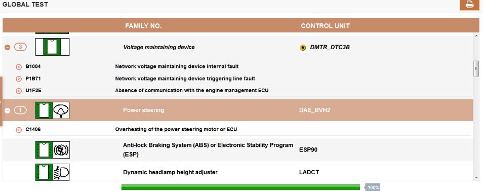

| Fault Code: | P1B71 |
| Description of Fault: | Network voltage maintaining device triggering line fault : Short circuit to earth or open circuit. Short circuit to earth for 500 ms |
| Conditions for Fault to clear: | - |
| Downgrade Modes whilst Fault is active: |
| Symptoms: |
| Suspect Areas: |

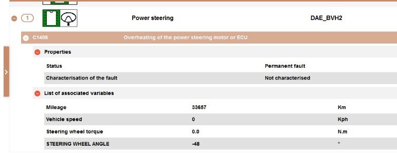

| Fault Code: | C1406 |

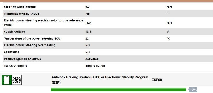

| Description of Fault: | Overheating of the power steering motor or ECU. Possibility 1 - The operating temperature of the electric power steering motor is too high - The time for recording the fault code is 1 milliseconds Possibility 2 - The temperature of the electric power steering ECU is too high - The time for recording the fault code is 1 milliseconds |
| Conditions for Fault to clear: | Ignition switched off and on again |
| Downgrade Modes whilst Fault is active: | Limiting of the assistance by at least 60 % following the increase in temperature |
| Symptoms: | Steering stiff |
| Suspect Areas: | Electric power steering ECU |
| Fault Code: | U1F2E |
| Description of Fault: | Absence of communication with the engine management ECU. Absence of communication with the engine management ECU on the intersystems CAN. |
| Downgrade Modes whilst Fault is active: | Automatic stopping of the internal combustion engine not possible (Stop and Start function) |
| Symptoms: | Absence of automatic stopping of the internal combustion engine |
| Suspect Areas: |

| Fault Code: | B1003 00 |
| Description of Fault: | Configuration fault. Configuration procedure interrupted or incomplete. Possibility 1 The following conditions have to be met - Vehicle stationary - Ignition on - Vehicle not in economy mode - Built-in systems interface supplied and not on standby Possibility 2 The following conditions have to be met - Engine running - Built-in systems interface supplied and not on standby |
| Conditions for Fault to clear: | The configuration has been carried out successfully |
| Downgrade Modes whilst Fault is active: | Deactivation of the cruise control and/or speed limiter function |
| Symptoms: |
| Suspect Areas: | Configuration of the BSI |

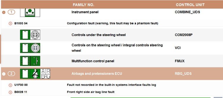

I'm having to type this yet again. When typing, the timer on being logged on to this site starts. It will then time out, log me off and then lose all my typing - How can this be avoided please?
Anyway better news,
I cleared all the faults except the two engine mangement (dpf filter & injector), one BSI & one Instrument panel - both showing as probably phantom.
Went for a quick test drive and the only faults to reappear are on the airbag (I had disconnected the battery to investigated these, which then caused the alarm problem). BUT have now got a communication error with the siren. I forgot to plug it back in - how silly of me
I'm out of time today, so will reconnect tomorrow - but it is quiet when the car is locked by the remote
I'll see what other faults reappear and give and update next week when the spare alarm module should arrive.
One very late thought. I had to replace the car battery at the begining of the year as it died on me so some codes maybe from that. In hindsight I should have cleared the codes after, but as I usually see some when I do a global test and the battery was healthy I generally ignore them unless its in an area I'm investigating - sorry.
Anyway better news,

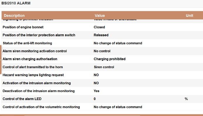

Alarm/siren

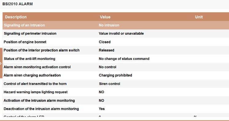

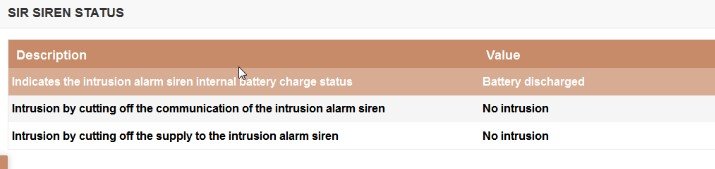

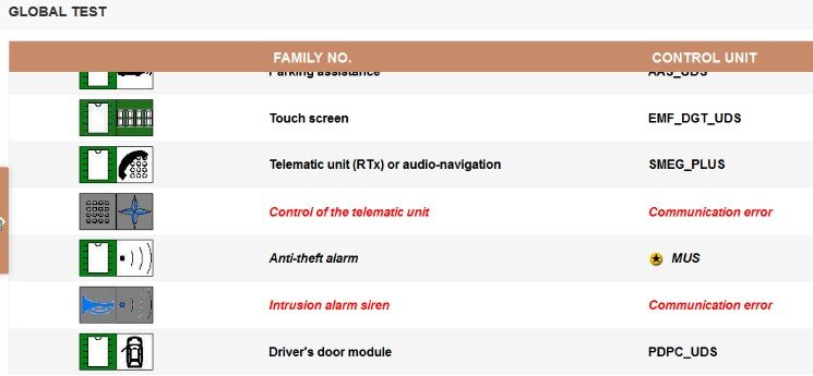

I looked at the siren on Sunday and it appeared to be connected, but Diagabox still showed a communication error. Yesterday I got proper access behind the wheel arch liner and discovered that the connector hadn't been fully pushed home.
BUT with the siren disconnected the alarm behaves as it should except for the audible part. Locking the car using the remote button, had the indicators flashing in the normal way. If I deliberately triggered the alarm e.g. unlocking the door by the key and not the pushbutton, it caused the indicators and the internal alarm activation indicator to flash until cancelled.
When I have reconnected the replacement siren, it sounds immediately on locking the car with the remote. I'm was wondering if it just needed time to recharge the internal battery or if I have a second duff unit, or something else. I had measured 12.7V on the connection to the siren at all the times (ignition on/off, locked & alarm on both immediately and after 5 minutes). So it either charges continuously, or only when the ignition is on (as Marc suggested) being controlled by a signal from the BSI.
So I had a look at the standard parameters for the BSI alarm. This showed "Alarm charging authorisation" as "Recharge Authorised" (this is authorised by the ignition being on). So I thought good, all I have to do is drive the car for a while and it will recharge. So on a few journeys yesterday & today (driving in total for nearly 2 hours) I have checked and the BSI continues to say "Recharge Authorised", but the siren itself still only displays "Discharged". I was hoping that the siren status would have changed from "Discharge" to "charging" when driving. It may just go from "discharged" to "charged" after several hours of driving, but I'm now concerned that it may have latched itself into not charging?

BSI Reset
As a final test I did another BSI reset (or attempt at one). I followed the instructions as best as I could (auto lights), but on locking the car after programming the keys, the car does not lock. I have to press unlock first, then it will lock. Note that the bonnet is still open as the closing of this is not stated during the process. Should it be closed before locking the car for the first time? Also on the "then operate Central locking several times" stage, should this be lock (the car is unlocked) or "lock" first?
The BSI reset made no difference except it reproduced the "lack of coherence... door.. lock status.." and the "power steering overheating" faults. I noticed that the power steering fault is at 33657km (=20913 miles). The car is now on over 141k miles, so is this an old fault that it is remembering at reset? I'm unsure of the mileage shown for the lack of coherence fault, I thought I had recorded this before deleting the fault, but I hadn't. So am I doing the BSI reset correctly / should I keep investigating or assume that the BSI needs reprogramming by Peugeot?

Alarm/siren
I tried to see if there was a way to reset the siren under the pack repair for the siren, but on the replacement parts menu it only has the configuration (intermittent or continuous).
I will give the replacement unit a time to charge and see what happens unless anyone has a better suggestion.
Other faults
Over the last few days I've done a bit over 250 miles during several journeys (before pushing the alarm plug fully home).
I have found out what the problem is with the airbag. The wire under the seat has been pressed by the padding against the metal frame enough for it to force the wire core to the surface. This core then occasional touches the seat frame. The only other fault to reappear (apart from those listed in my previous post) is the "Fault adaptation of the windscreen sensor impossible". This appears at initial ignition on. I think that I am to blame for this. The wiping speed for rain density was not quite right, so I investigated this when I connected Diagbox to look for the airbag problem. Unfortunately, I did an initialisation, which did not complete. I suspect more start conditions are required than Diagbox suggests. Note that if I clear this fault both the auto wipers & lights work normally.
BSI Reset

Quick update on the BSI reset. Seeing others do this on internet, they do an additional step of open/close driver's door before the "operate Central locking several times" and after the "Switch off ignition, remove key through window" step.
Repeating the reset with this extra step, I no longer get the "lack of coherence......lock..." fault. I haven't noticed anything else changing.

Does anyone have any idea what these faults could be?
Everything died about a month ago, no lights on dashboard, couldn't open doors even though car was unlocked etc. Today it did it again, key fob wouldn't unlock the car, key in the door couldn't unlock the car, no dash lights (except alarm flasher), and after 5 mins all was normal again!
It also has an intermittent issue - every so often when I do over 50 it judders as if it's going to stall. I switch back down to fourth and work up through the gears again and all is fine.
Really grateful if anyone has any ideas!
