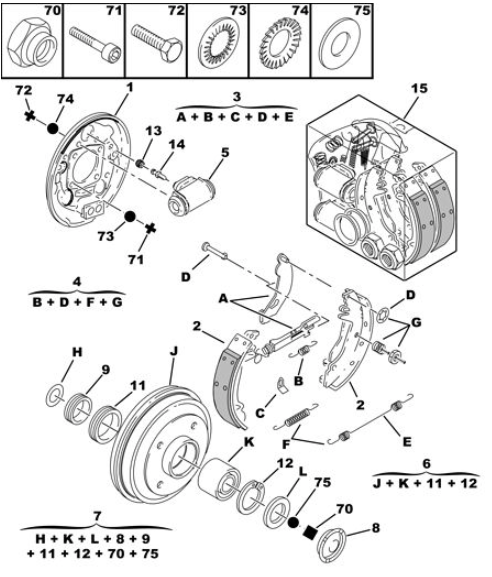

Ok, so for your vehicle, it could of been fitted with either a Girling or Bendix rear brake system. Which you have, Citroen don't specify, so I will put up both diagrams and you will have to advise which you have and then the item numbers you require:
Both have a 4-shoe pre-fit Brake Kit (15) or (16) depending on which diagram you are looking at.
Bendix Rear Brakes
(1) OEM Brake Plate Left, Part: 421169 (NFP)
(1) OEM Brake Plate Right, Part: 421269 (NFP)
(6) BRAKE HUB AND DRUM, Part: 424732 (NFP)
(7) OEM REAR HUB BEARING, Part: 374817 (NFP)
(7) Cheaper Alternative, Part: 1681935380, £24.17
(15) OEM 4-SHOE PRE-FIT BRAKE KIT, Part: 42415Y (NFP)
(15) Cheaper 4-SHOE PRE-FIT BRAKE KIT, Part: E170063, £92.03
Girling Rear Brakes
(1) OEM Brake Plate Left, Part: 421170 (NFP)
(1) OEM Brake Plate Right, Part: 421270 (NFP)
(16) OEM 4-SHOE PRE-FIT BRAKE KIT, Part: 42414R (NFP)
(16) Cheaper 4-SHOE PRE-FIT BRAKE KIT, Part: E170034, £93.00
Note: (NFP) = No longer Available from Citroen

I haven't yet got to getting the rear wheels off but I know the front are Girling callipers. I will add a photo if this helps identify? I appreciate it's from the back...
- x 6963
Re: 1993 Citroen ZX Rear Drum Brake Part Numbers.
Ok, I can't help you identify the make, but I've updated my last post with the main part numbers of the kits for both. You will note the hub bearing is the same for both. I've included the parts for the items no longer available from Citroen (NFP) so that you can still search elsewhere on the part numbers. Autodoc have some of these parts.

I recall you can tell from the shape of the cylinder poking through the back plate - Bendix appears to be round, Girling oval.
