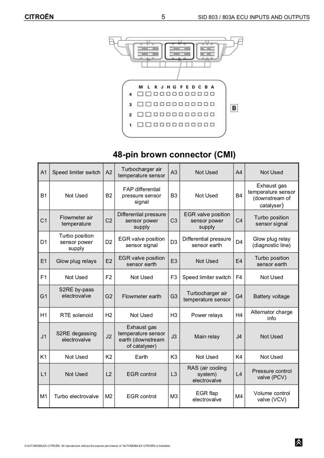

Re: 307 HDI 2.0l non starter.
Found a great ECU wiring pinout. The forum may want to put this somewhere easy to find, Oh crap it says it will not do a PDF or its too large, let me know if there is some other way to get it on your forum.
- Posts: 28660
- x 5670
Save it as a vector graphic ideally but a .png or .jpg may be acceptable.

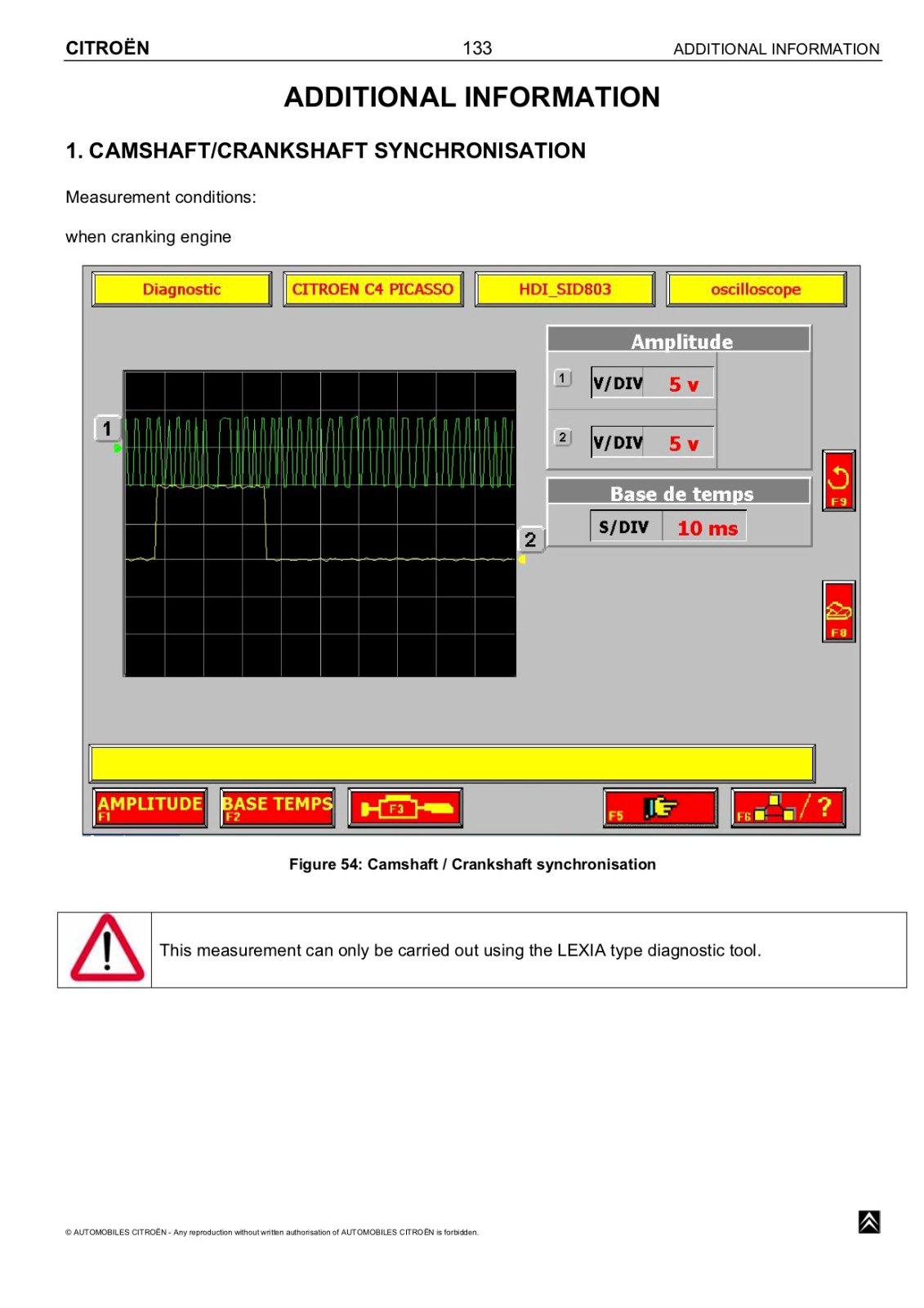

I've put it up in the air and had a good look at the wiring all tests fine, the crank sensor looks brand new but I did notice it doesn't fit quite right, pulled it off and whoever fitted has managed to bend it and won't sit flat when bolted down, I ll pick up a new one and go from there.
The PDF is 147 pages long It will only save a JPG one page at a time. That will make a mess of this post, and I don't really want to spend that amount of time making a mess of your forum. If you PM me I'll email it to you. Here's the info I was looking for, every page is gold. It has what to expect on the scope, and how to test every sensor.
