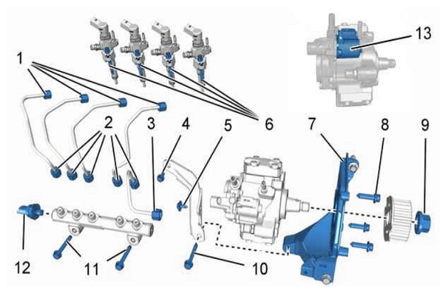

Re: Torque settings - 3008 Injectors
DV6C 8 Valve Engine.
Note: DV6C Engine Only!
| Ref | Designation | Stage | Tightening torque |
| (1) | Connections (Diesel injector ) | Pre-tighten | 2 daNm |
| (1) | Connections (Diesel injector ) | Tightening | 2,5 daNm |
| (2) | Connections (Fuel high pressure pipes / Fuel high pressure common injection rail ) | Pre-tighten | 2 daNm |
| (2) | Connections (Fuel high pressure pipes / Fuel high pressure common injection rail ) | Tightening | 2,5 daNm |
| (3) | Union (High-pressure fuel pipe / Fuel high pressure pump) | Pre-tighten | 2 daNm |
| (3) | Union (High-pressure fuel pipe / Fuel high pressure pump) | Tightening | 2,5 daNm |
| (4) | bolts (Fuel high pressure pump rear bracket) | Tightening | 1 daNm |
| (5) | bolts (Fuel high pressure pump rear bracket) | Tightening | 1 daNm |
| (6) | bolts (Diesel injector fixing flange) | Pre-tighten | 0,7 daNm |
| (6) | bolts (Diesel injector fixing flange) | Angular tightening | 80° |
| (7) | bolts (Fuel high pressure pump front bracket) | Tightening | 2 daNm |
| (8) | bolts (Fuel injection pump / Bracket ) | Tightening | 2 daNm |
| (9) | Fuel injection pump pulley nut | Tightening | 5 daNm |
| (10) | bolts (Fuel high pressure pump rear bracket) | Tightening | 2 daNm |
| (11) | bolts (Fuel high pressure common injection rail / Engine block) | Tightening | 2 daNm |
| (12) | Fuel high pressure sensor | Tightening | 4,5 daNm |
| (13) | bolts (Fuel pressure regulator / Fuel high pressure pump) | Pre-tighten | 0,3 daNm |
| (13) | bolts (Fuel pressure regulator / Fuel high pressure pump) | Tightening | 0,7 daNm |
- x 6955
