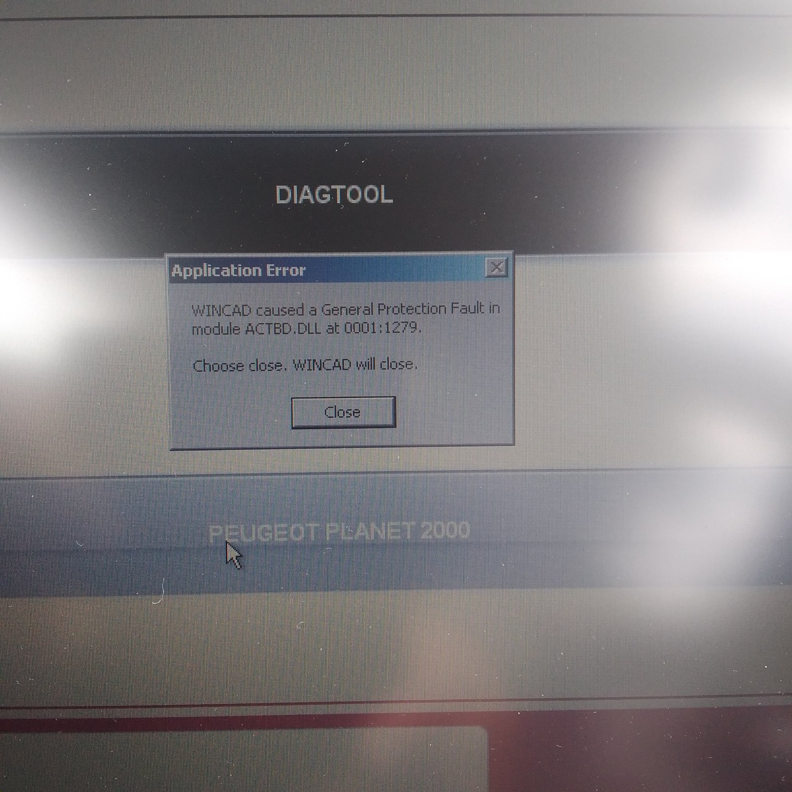

Re: Dash board notification messages.
Post by Huskyxantia »
So, mine should be ok in one sense operating system but sounds like possible hardware problem
Heres what i was getting.
My nag screen
My nag screen
Husky. :?
Post by GiveMeABreak »
That's an error concerning VMs on older software - PP2000 and Lexia software are older 16 bit programmes that aren't supported on native 64 Bit systems unless running in a 32 bit VM.
Read this article here to save regurgitating: :wink:
https://www.peugeotforums.com/threads/w ... ase.20998/
