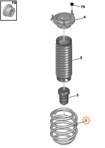

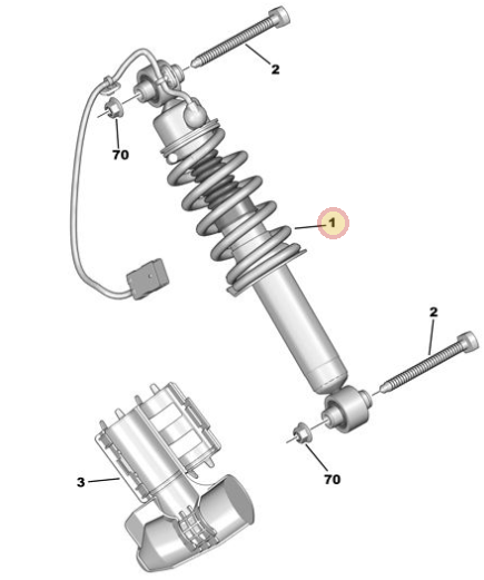

Ok, so first off, no, the fronts are unique to the models and as you have a 2.7 V6 it has variable suspension. Front springs are no longer shown as available from Peugeot, but the front variable dampers are still available.
Regarding the rears, the problem you will have is that the springs are not available separately. The unit is a combined variable suspension damper, so has the spring on the damper itself. These are showing as still available though.
Front Springs
Part: 5002KX, No Longer Available, but were £132.98 each when last they were.
Rear Damper / Spring Module Combined.
Item (1) Part: 5207C7, £374.40 each
So that's why you are probably having issues with the rears.

No they are not interchangeable. V6 (2.7 and 3.0) versions have variable suspension that is not on the other models and use different versions. All the struts on these V6 models have variable dampers and are linked to the suspension ECU. They are a specific type.
