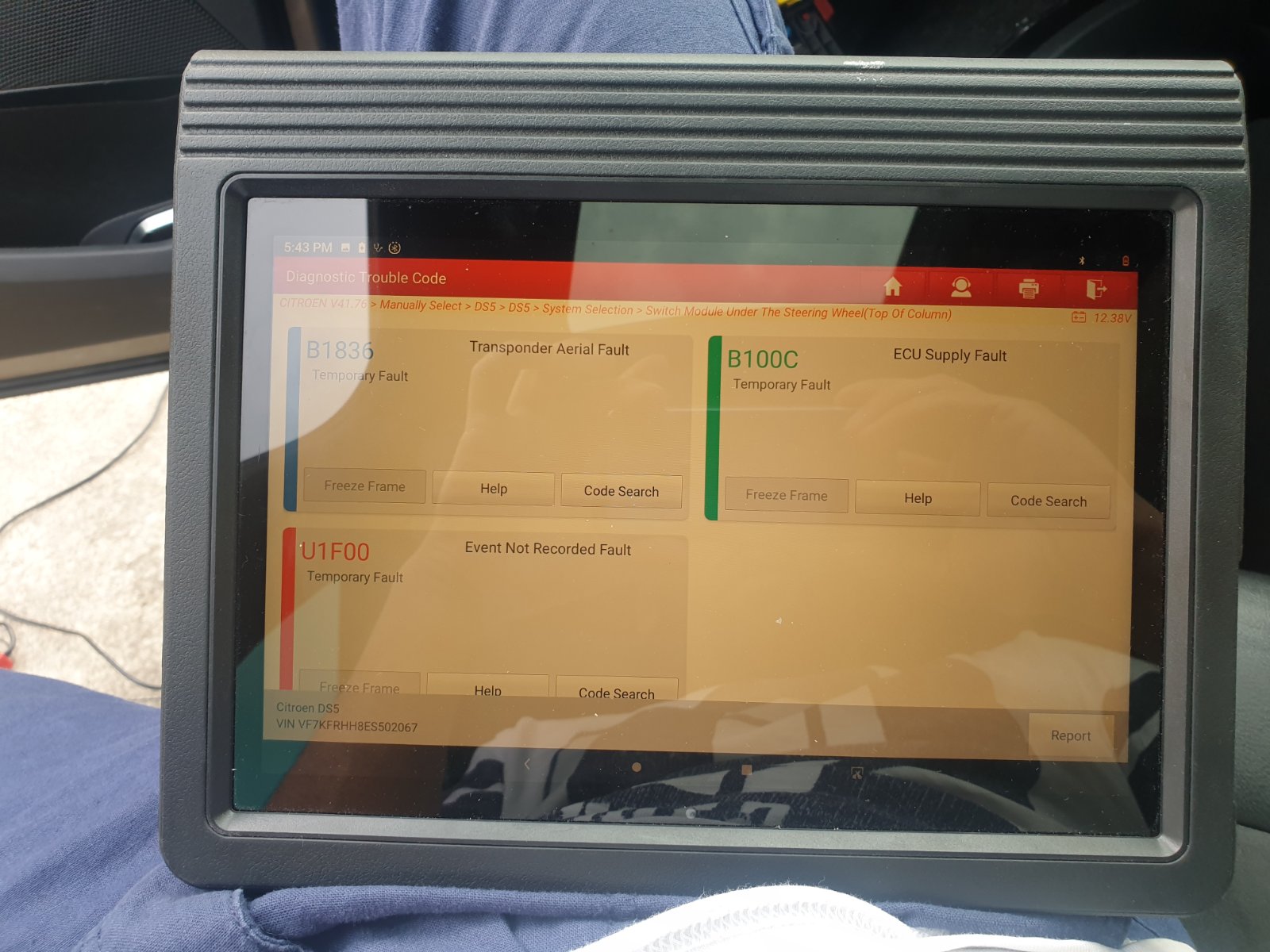

Hey guys I have a citroen DS5 style 2.0 hdi manual 2014 ,when keys inserted into key reader I push the start button & i get no response no ignition nothing the remote locks the doors but nothing on the speedo not even a key not recognised or any lights what so ever.
Check pic for fault codes picked up ,any ideas would be appreciated ,I've checked all the fuses changed the key reader and alarm ecu module I havnt changed the adml cemo bml ecu relay module.
- x 6957

Unfortunately, you seem to be missing some of the fault code. There is usually another 2 numbers on the end which provide more information as to which system or sub-component is faulty. Your diagnostic kit may not be able to read the codes.
The only vague information I have is a supply fault to the reader:
B100C 1C Electronic steering lock supply fault. This means there is a supply fault, so it is not going to work, so won't recognise the fob.
U1F00 00 Event not recorded fault. This means the BSI has not received specific information from the ECU that recorded a fault, so it can't tell you anything else.
So needs further investigation as to where the supply fault is.
The first thing I would check is Fuse F9 in the engine fuse box. Then check Fuse F8 in the BSI.

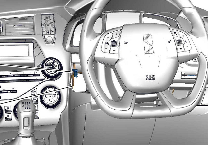

These may help with checking your wiring connections...
Electronic Steering Lock
AE00: electric steering lock
PSF1: engine compartment fusebox panel
BSI1: BSI
Electronic Key Reader
8239: hands-free access and starting electronic key reader
8235: engine starting switch

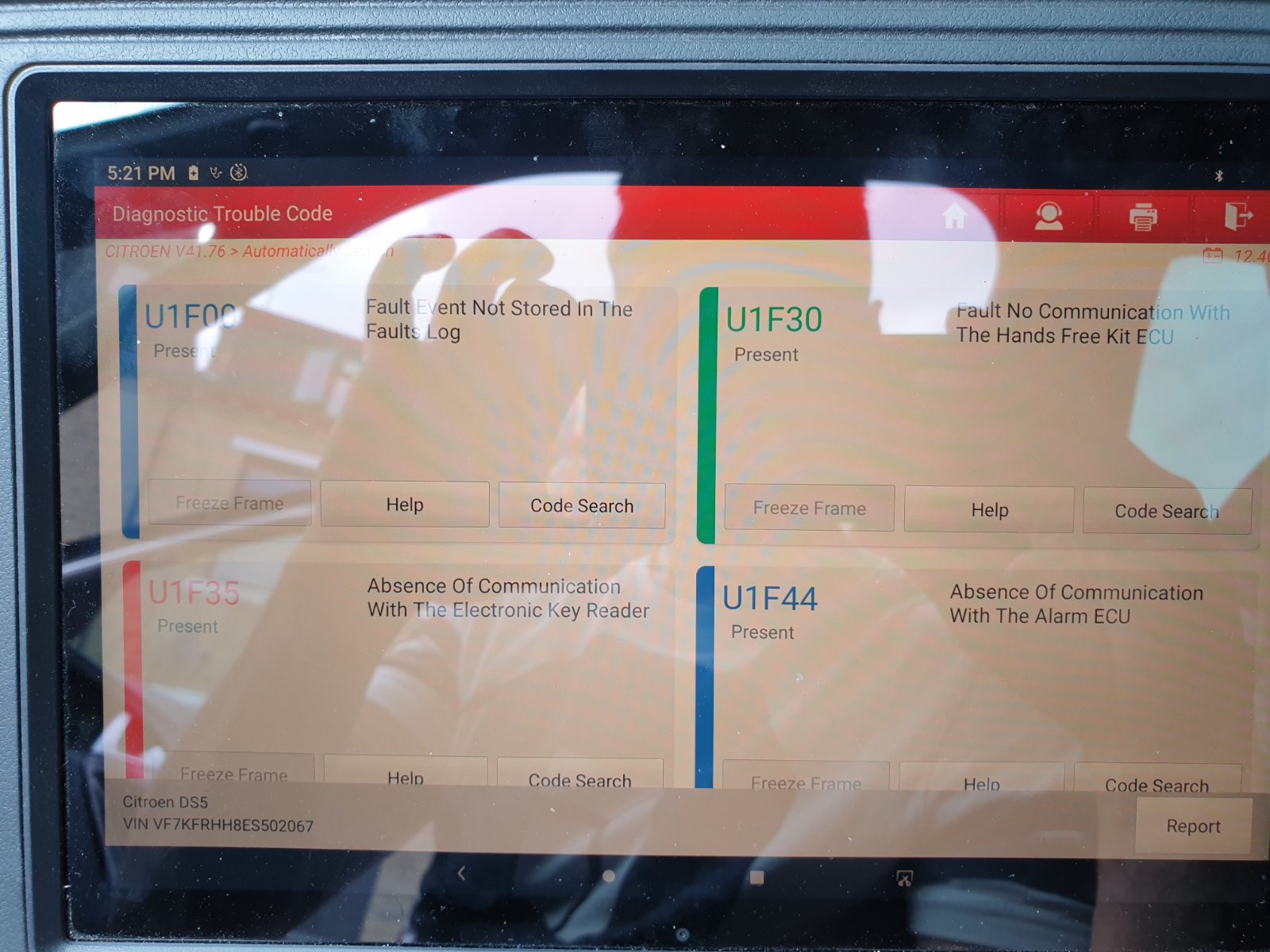

Thanks bro appreciate your time and diagrams i think I have another screen shot of the codes what you think of these ,I will try and get a different diagnostics on the car and report back with the codes

Seems like I have no communication with electronic key reader ,alarm ecu and hands free kit ecu which i have tried 2nd hand units but to no avail

I have a little more info on a couple of those faults:
If you haven't changed any configuration with your diagnostic tool in the BSI or elsewhere, then there may be an issue with the low speed CAN data network.
| Fault Code: | U1F35 87 |
| Description of Fault: | _absence of communication with the electronic key reader. Absence of communication with the electronic key reader (For 2 seconds). |
| Conditions for Fault to clear: | Communication with the electronic key reader (For 2 seconds). |
| Downgrade Modes whilst Fault is active: | - |
| Symptoms: |
| Suspect Areas: |
| Fault Code: | U1F30 87 |
| Description of Fault: | _absence of communication with the hands-free unit. Absence of communication with the hands-free control unit (For 2 seconds). |
| Conditions for Fault to clear: | Communication with the hands-free control unit (For 2 seconds). |
| Downgrade Modes whilst Fault is active: | Hands-free remote control present in the electronic key reader - Starting possible if the vehicle has not got a hybrid drive chain - Activation of the power unit if the vehicle has a hybrid drive chain |
| Symptoms: |
| Suspect Areas: |

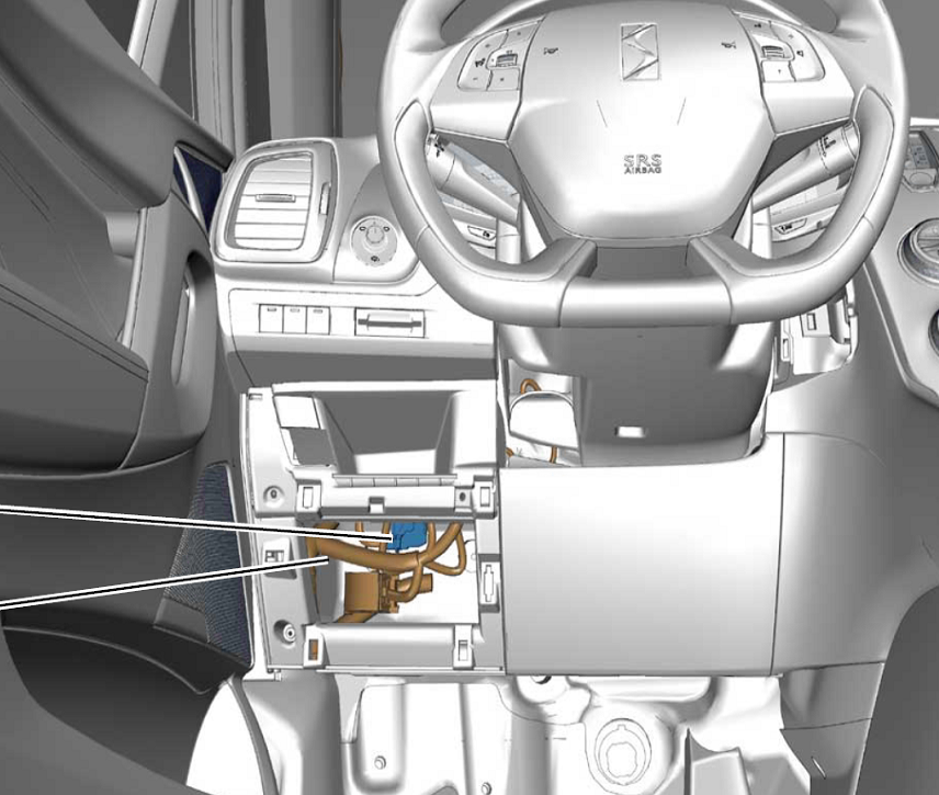

Thanks Marc you're very helpful, ok so is the ADML unit located behind the BSI the hands free unit?

Hands Free Reader ADML Location Although this shows left hand drive it will be in the same place - inside the passenger glove box near the BSI somewhere.Cruiser786 wrote: 27 Jul 2022, 11:42 Thanks Marc you're very helpful, ok so is the ADML unit located behind the BSI the hands free unit?
