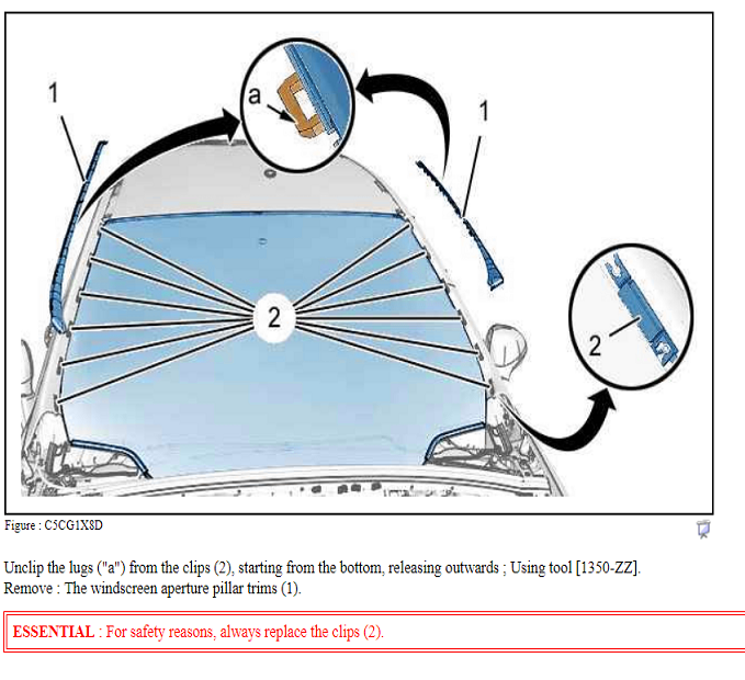

That is essential when replacing the trim as it's a safety factor that holds the trim in place. If they have not done this - complain and get them to do it as it is a manufacturer recommendation.
Your sensor will have weakened performance guaranteed. It has 16 adjustable speed levels to meet all conditions, and you may find that the sensitivity has diminished greatly as a result, resulting in less wiping of fine rain and also poorer light detection.
Personally, I just can't abide sloppy work. The repairs are guaranteed. If you are not happy, make a complaint and stand your ground. They have insurance to cover things like the sensor. But unforgiveable regarding the clips as this is a safety issue and they must be replaced. The fitters on all my replacement windscreens always replaced with new clips.

I spoke to the guy about the clips when he fitted them he replaced 4 broken ones, but he said that they said it's okay to reuse?
So I'll ask them to replace all of them as that's the proper way right?

It's a safety issue and if they are supposed to be replacing the windscreen then it should be to the manufacturer's own safety standards. See below in Red:
Click Image to Zoom
Click Image to Zoom
