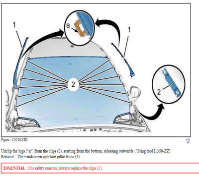

I spoke to the guy about the clips when he fitted them he replaced 4 broken ones, but he said that they said it's okay to reuse?
So I'll ask them to replace all of them as that's the proper way right?

It's a safety issue and if they are supposed to be replacing the windscreen then it should be to the manufacturer's own safety standards. See below in Red:
Click Image to Zoom
Click Image to Zoom
