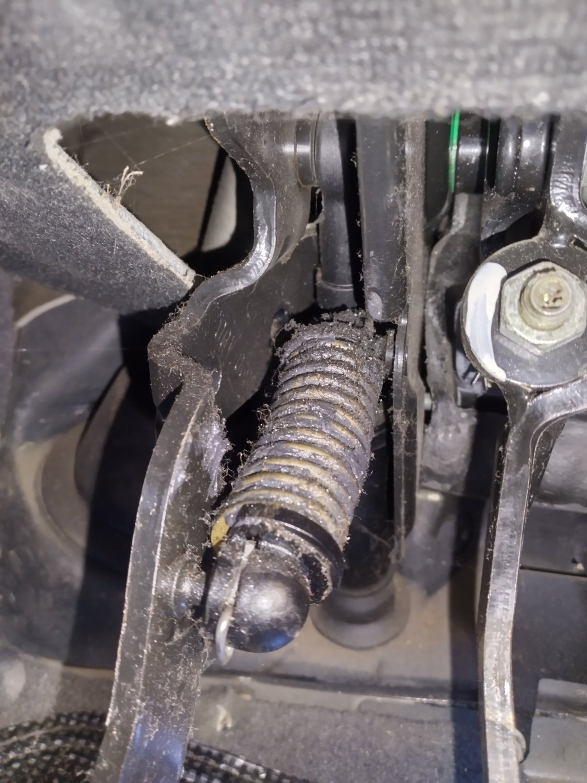

Marc could you please tell me if the spring in my picture is operating correctly or not ? Thanks

The spring is 100% not sitting correct. It should always be straight no matter where it is in its travel.

Looks like the bottom part of the spring assembly is broken - just hope that's the last of the problems here - didnt dare to take it off without the new one tho

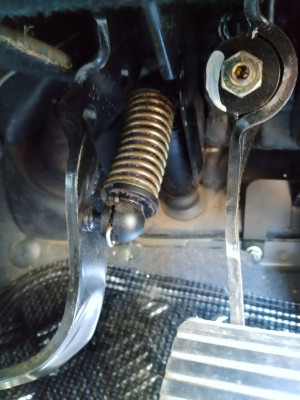

My clutch pedal spring.

My spring is this colour when clean. Did you buy the car off a boy racer?
, I had to clean it, it looked horrible in the photos.

Hehe - nope! But thanks a lot for the photos - parts should be here on Saturday or Monday. It looks to me from your pic that the resting position of the clutch is higher than that of the brake pedal - as mine is they are level.

Now you mention it the clutch pedal is slightly higher than the brake pedal. I imagine it's a safety thing for braking hard. As for the slave I'm not sure. I certainly wouldn't replace the slave until the spring is done. Who would of thought if I asked that stupid question at the start it could of been solved by now.

I don't think the bracket is an issue, it's probably different because looking at the photos yours is LHD and mine is RHD. Looking back at the diagrams that Marc sent you it looks perfectly normal.

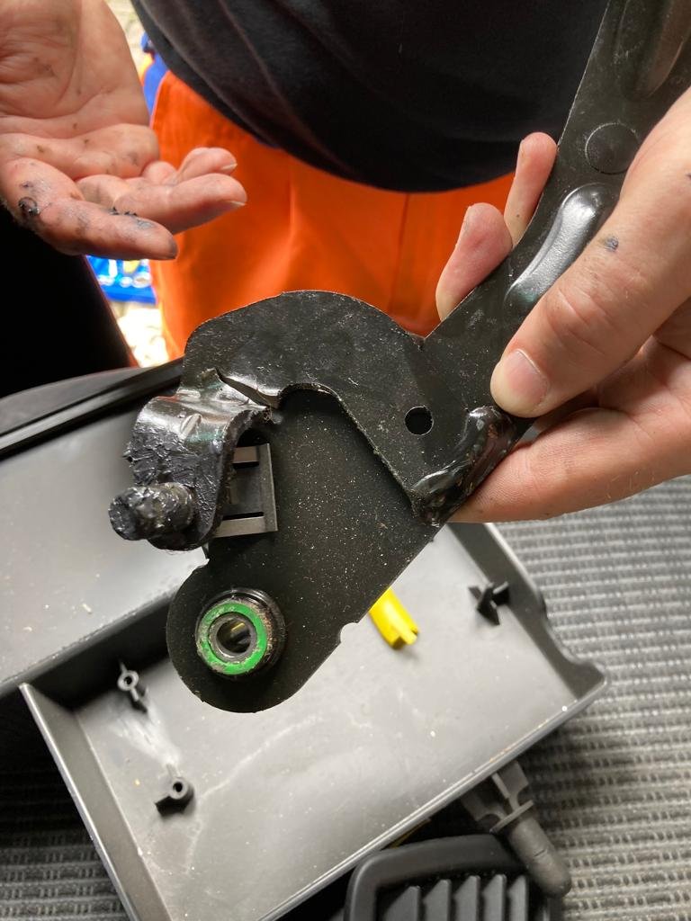

Ok myself and a real mechanic went at it today:
  • Spring and assembly fine - identical to spare parts
    Broken clutch pedal
See picture...
Now what could possibly have caused such a break??
Any advice most gratefully received.
