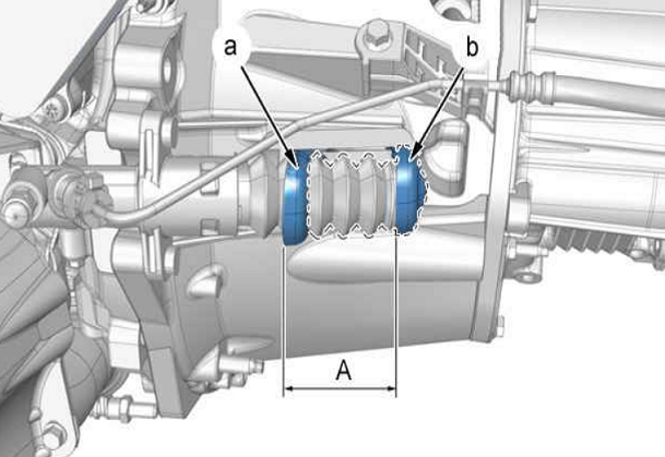

With regard to what I said above and what Wheeler has chipped in with, this is the diagram of the slave cylinder and where the travel is measured from.GiveMeABreak wrote: 02 Jun 2022, 17:47However it may also be related to the hydraulic clutch control. There are various tests that would need to be undertaken including measuring the travel of the slave cylinder from when the declutched to clutched position is made and comparing values. There are other checks, but all these need undertaking to determine the casue, so I don't see how they can just fob you off with getting a new clutch and DMF!
Check the travel of the hydraulic slave cylinder or of the clutch cable, from the declutched position to the clutched position.
N.B. : Two people are required to perform the following operation.
Clutch Fork:
- "a" : Applied position
- "b" : Released position
Measure the travel "A" of the hydraulic slave cylinder or of the clutch cable.
The travel value measured should be 20mm.
If the value is not correct then check the travel of the hydraulic master cylinder.

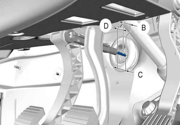

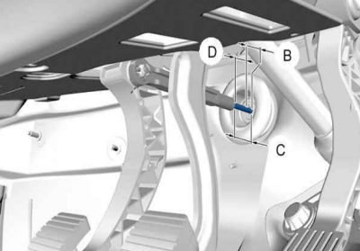

Checking the travel of the clutch hydraulic master cylinder
Clutch pedal:
- "B" : Applied position (In millimetres)
- "C" : Released position (In millimetres)
The correct value should be 28mm.
If the value is incorrect, then this usually means replacing the hydraulic clutch control (master cylinder, pipe and slave cylinder).

So as far as our first test went (and I'm not entirely sure we got this done perfectly) we measured this at 17mm - will test again tomorrow and test the master cylinder travel (might have to remove some plastic covers to get an accurate measurement).GiveMeABreak wrote: 02 Jun 2022, 20:14With regard to what I said above and what Wheeler has chipped in with, this is the diagram of the slave cylinder and where the travel is measured from.GiveMeABreak wrote: 02 Jun 2022, 17:47However it may also be related to the hydraulic clutch control. There are various tests that would need to be undertaken including measuring the travel of the slave cylinder from when the declutched to clutched position is made and comparing values. There are other checks, but all these need undertaking to determine the casue, so I don't see how they can just fob you off with getting a new clutch and DMF!
Clutch Fork:Press the clutch pedal.
