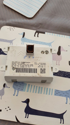

OK so I have a set off clocks from a 308cc that came with the orange matrix display I also have a colour matrix display that will physically fit in the clocks. The orange display is locked and cannot turn stuff on or off. The colour display if from a 208 which I believe is can 2008 (308 is can 2010)
So does anyone know how to unlock the orange display? or a way off converting the canbus so the colour screen will work. I remember reading someone had mad a convertor but for the life in me cannot find it again

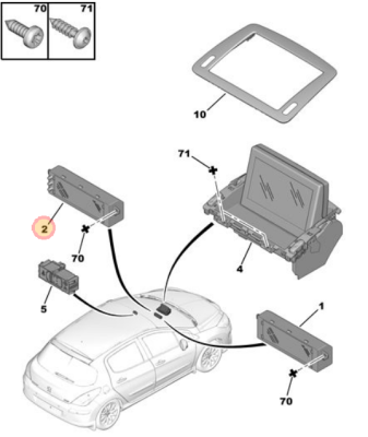

Ok, so here you go Ian:
Item (2), Parts
Peugeot OEM, Part: 659346, £286.08 (requires coding / configuring)
Peugeot Replacement Part for the above: 9821852480, £380.10
Peugeot pre-configured Part: 659347, £289.79 (no longer available.
So have a search on 659346 or 9821852480 for a replacement.
The above are from Peugeot and include VAT.

Item (2), Parts

Re: Colour matrix display
I'm not with you - the clock is part of the matrix screen (2).

This is the screen, its in the instrument cluster in the middle off the rev counter and speedo

Ok, the matrix display in the instrument panel. Unfortunately, your instrument cluster does not have a separate matrix screen shown as a replaceable part.
Also, be aware that changing these parts may increase your odometer reading, as the ECU in the instrument cluster will compare mileage recorded in the BSI and whichever has the higher mileage is then used to set both to that mileage.
Original Part number was: 610338, original £584.45
This has now been replaced with part number: 9806132580 £898.81
There are 2 other screens, neither for your vehicle, one of which has a replacement matrix display, the other does not.
Neither of the other 2 screens are compatible with your vehicle.
So the part numbers I have supplied are the official part numbers for the instrument cluster.
