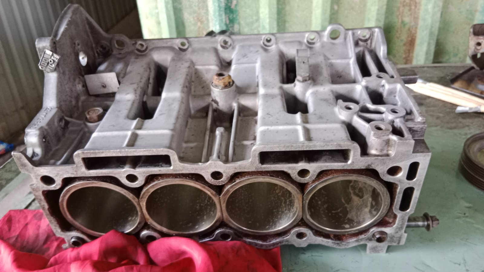

Bonjour! This petite French import 205 GL was still running when I bought it last December and I've just overhauled it. I've yet to find out which TU engine is in it; probably a TU3 A/K but the displacement (cc/cm3) isn't even listed in the Vietnamese vehicle registration! I've attached photos including the VIN plaque (VF3**************[VIN obfuscated, can be read by forum staff]) and two tags riveted to the engine with codes: K3A (legislation type?) and 1F SOC 673512. The single carb is Weber. I really need your expert engine identification please.

It's quite old so there is no useful data that was transferred over to the later electronic systems. All I have is what you already know - a Carburettor TU3 with K3A as the variant. From what I can see the original engine marking would of been K1A, but a replacement engine at the time would of been K3A designation.

The VIN provided the RPO code is the build date (4881). The K3A is the PSA engine designation and nothing to do with the Euro Emission Standards which didn't come into being until July 1992, so a few years early for those.
So the engine is CARBURETTOR TU3 with an engine designation of K3A.
