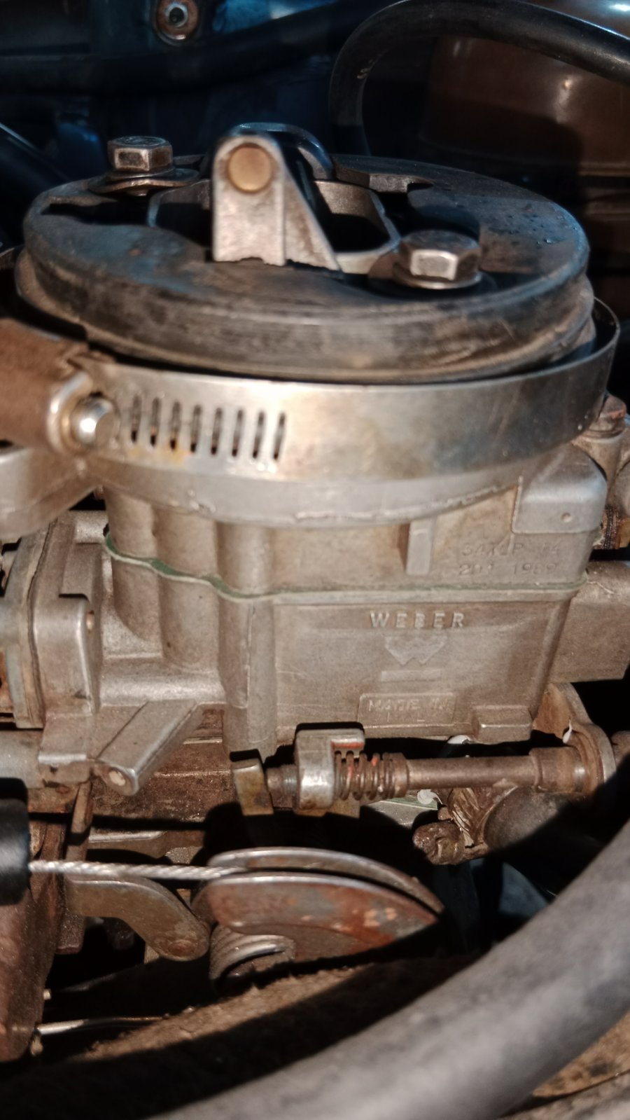

yes, the carburettor is an Italian made Weber with markings: 34TLP 14 and beneath that 201 1989.
The mechanic says that adjustments to the carb are limited because "it's worn-out and the electric pump is not working with the wiring cut off."
(He spoke to my wife in Vietnamese and I am not sure what he's talking about )
The car runs all right as long as the idling RPM is set high but jerks when set lower.
He suggest swapping it for a carb from a 1995 Mazda 323 (1.3).

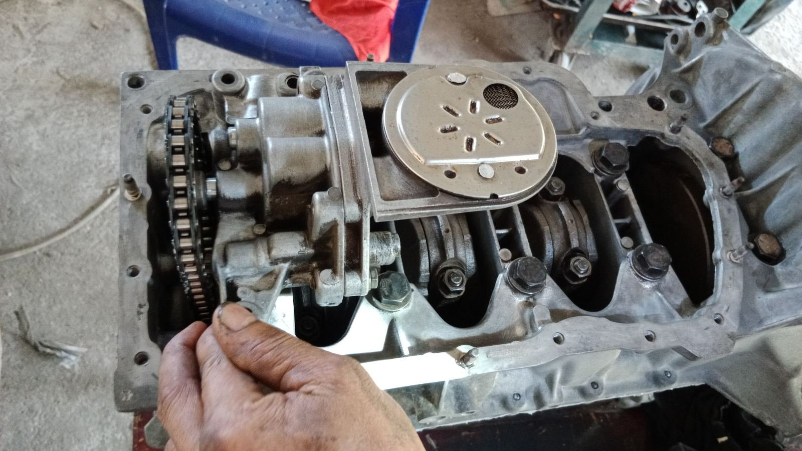

Another problem is noisy start up, sometimes with squealing belt slip and other "grinding-rumbling" noises which I don't hear anymore once the car gets going. These noises seem to come from the area where the AC compressor and alternator belts are connected to the crankshaft.
I haven't much confidence with the way they adjusted the valve clearances and timing belt tension without any precise measuring tools.
I am not sure that is the cause and I can't make out if there are noises from the valves above the general din of the engine.
Would you please advice on these issues?

In any case I've decided not to change the carb set up, I think it's working well enough.
The major problem I have to deal with now concerns the crankshaft which causes the grinding rumbles because of faulty installation and bearings.

As for the grumbling from the crank area, I’d be inclined to check the condition and alignment of the belts first, then check for any worn out bearings in the crank pulley. I assume yours doesn’t have PAS?
