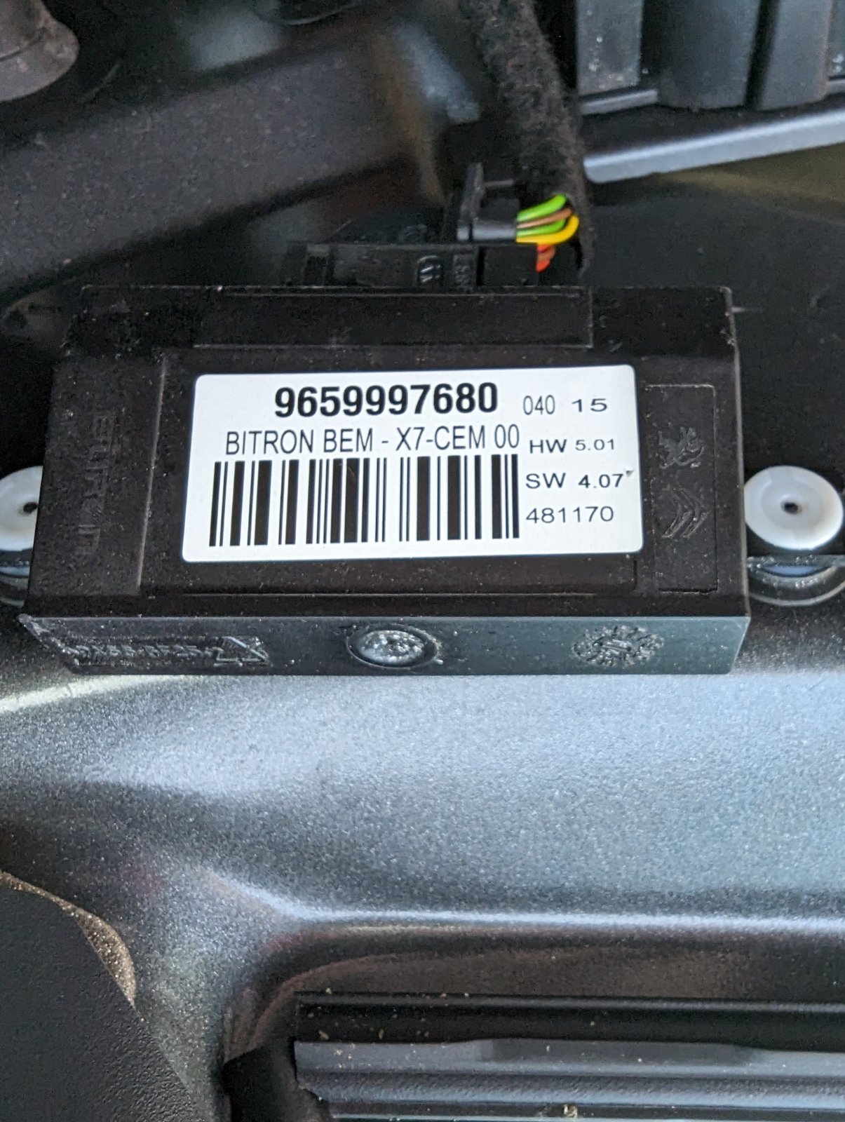

matthewpjgrant
- Posts: 8
- Joined: 06 Jan 2023, 16:08
Re: Citroen C4 Picasso (B78) 2014 - keyless door handle issue
Hey, did you ever get the issue resolved and how so?
I've been having the same issue on the passenger side for over a year now! It won't activate to lock or unlock the door and it's annoyed me long enough to want to do something about it now.w
I've tried putting the key in the reader, disconnecting the battery overnight, and even swapping the handle for the driver's side. The passenger side handle didn't work on the driver's side. Broken handle and replacement needed I assumed, but then the driver's side handle wouldn't work on the passenger side either. I also tried pulling the battery and locking the car via fob a few times to see if the change in handle needed to register with the ECU. A pointless exercise in fault-finding all around really!
I've connected it up to a copy of diagbox but I can't seem to find anything on there relating to the doors other than a simple test to check whether the actuators for the locks themselves work. I've seen on other forum posts that a "reset" at the dealer fixed their issue- Can anyone point me in the right direction?
I'm starting to think that maybe it's not the handle itself (mostly because I'm reluctant to buy another and have wasted money if the problem persists) but perhaps an ECU or cable issue. From the limited info I can find, is this the "Door Control Module" and would that have anything to do with the door handle? Would it have anything to do with adjusting the passenger side mirror (a whole other saga where it won't move left or right and up has become down).
Thanks to all who can help!

Dormouse
- Posts: 2145
- Joined: 15 Apr 2021, 14:32
- x 696
Blame Bobins but I remember reading about damaged PCBs inside the door handles of this system. If all else fails, get the door handles off and examined for PCB issues.

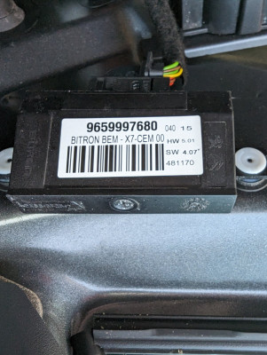

Hello Where did find this central locking module? Thanks

Read this thread a few times since it was posted. My car developed intermittent hand free opening which developed to not working at all. The hand free locking works fine. Since there are two wires carrying the signal to the HFECU. Is it a case that one carries opening signals and the other closing signals or the pair carry both opening and closing signals together. So on that basis, best bet do I check wiring or replacement handle?
Cheers.
