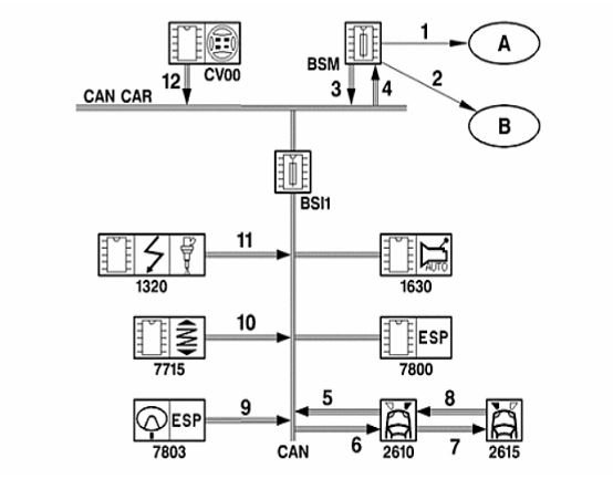

I have to go out shortly, but here is a diagram with the components that may help you:
Key:
  • Single arrow: Wire connection
  • Triple arrow: Multiplexed connection
Note: The left headlamp is the "master headlamp".
The right headlamp is the "slave headlamp".
ComponentsComponents
CV00Switch module at the steering wheel
BSI1Built-in systems interface
BSMEngine fuse box
1320Engine ECU
1630automatic gearbox
2610Left-hand headlamp
2615Right-hand headlamp
7715Suspension ECU
7800Dynamic stability control ECU(ESP)
7803Steering wheel’s angle sensor
ARight xenon bulb
BLeft xenon bulb
Here is a table showing the nature of the communication between the various components:
No. of linkTransmittersignalNature of signal
1Engine fuse boxRight xenon bulb controlfilament
2Engine fuse boxLeft xenon bulb controlfilament
3Engine fuse boxLeft dipped headlamp diagnostics. Right dipped headlamp diagnosticsBody CAN
4BSI1Dipped beams controlBody CAN
5Left-hand headlampAutomatic headlamp height adjustment lighting status. Left headlamp lighting statusCAN
6Dynamic stability control ECU. automatic gearbox. BSI1Vehicle speed. Gearbox ratio engaged. Status of the dipped headlamps. Activation of the daytime-running lamps. Inhibiting of the dynamic directional lightingCAN
7Left-hand headlampTurning reference value. Height reference valueLIN
8Right-hand headlampRight headlamp turning fault. Right headlamp height faultLIN
9Steering wheel’s angle sensorSteering wheel angle. Direction of rotation from the steering wheel angle sensor. Steering wheel angle sensor fault codeCAN
10Variable damping suspension ECUVEHICLE RIDE HEIGHTCAN
11Engine ECUInternal combustion engine statusCAN
12Switch module at the steering wheelSidelamps/dipped headlamps inverter. ConcealerBody CAN

Just be very careful if checking connections due to the residual high voltage of the discharge lamp system near the ballast and wear rubber gloves.
