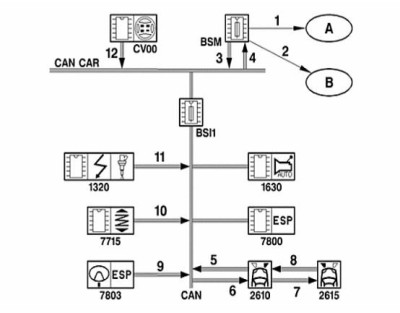

I have to go out shortly, but here is a diagram with the components that may help you:
Key:
The right headlamp is the "slave headlamp".
Here is a table showing the nature of the communication between the various components:
Key:
- Single arrow: Wire connection
- Triple arrow: Multiplexed connection
Components | Components |
CV00 | Switch module at the steering wheel |
BSI1 | Built-in systems interface |
BSM | Engine fuse box |
1320 | Engine ECU |
1630 | automatic gearbox |
2610 | Left-hand headlamp |
2615 | Right-hand headlamp |
7715 | Suspension ECU |
7800 | Dynamic stability control ECU(ESP) |
7803 | Steering wheel’s angle sensor |
A | Right xenon bulb |
B | Left xenon bulb |
No. of link | Transmitter | signal | Nature of signal |
1 | Engine fuse box | Right xenon bulb control | filament |
2 | Engine fuse box | Left xenon bulb control | filament |
3 | Engine fuse box | Left dipped headlamp diagnostics. Right dipped headlamp diagnostics | Body CAN |
4 | BSI1 | Dipped beams control | Body CAN |
5 | Left-hand headlamp | Automatic headlamp height adjustment lighting status. Left headlamp lighting status | CAN |
6 | Dynamic stability control ECU. automatic gearbox. BSI1 | Vehicle speed. Gearbox ratio engaged. Status of the dipped headlamps. Activation of the daytime-running lamps. Inhibiting of the dynamic directional lighting | CAN |
7 | Left-hand headlamp | Turning reference value. Height reference value | LIN |
8 | Right-hand headlamp | Right headlamp turning fault. Right headlamp height fault | LIN |
9 | Steering wheel’s angle sensor | Steering wheel angle. Direction of rotation from the steering wheel angle sensor. Steering wheel angle sensor fault code | CAN |
10 | Variable damping suspension ECU | VEHICLE RIDE HEIGHT | CAN |
11 | Engine ECU | Internal combustion engine status | CAN |
12 | Switch module at the steering wheel | Sidelamps/dipped headlamps inverter. Concealer | Body CAN |
