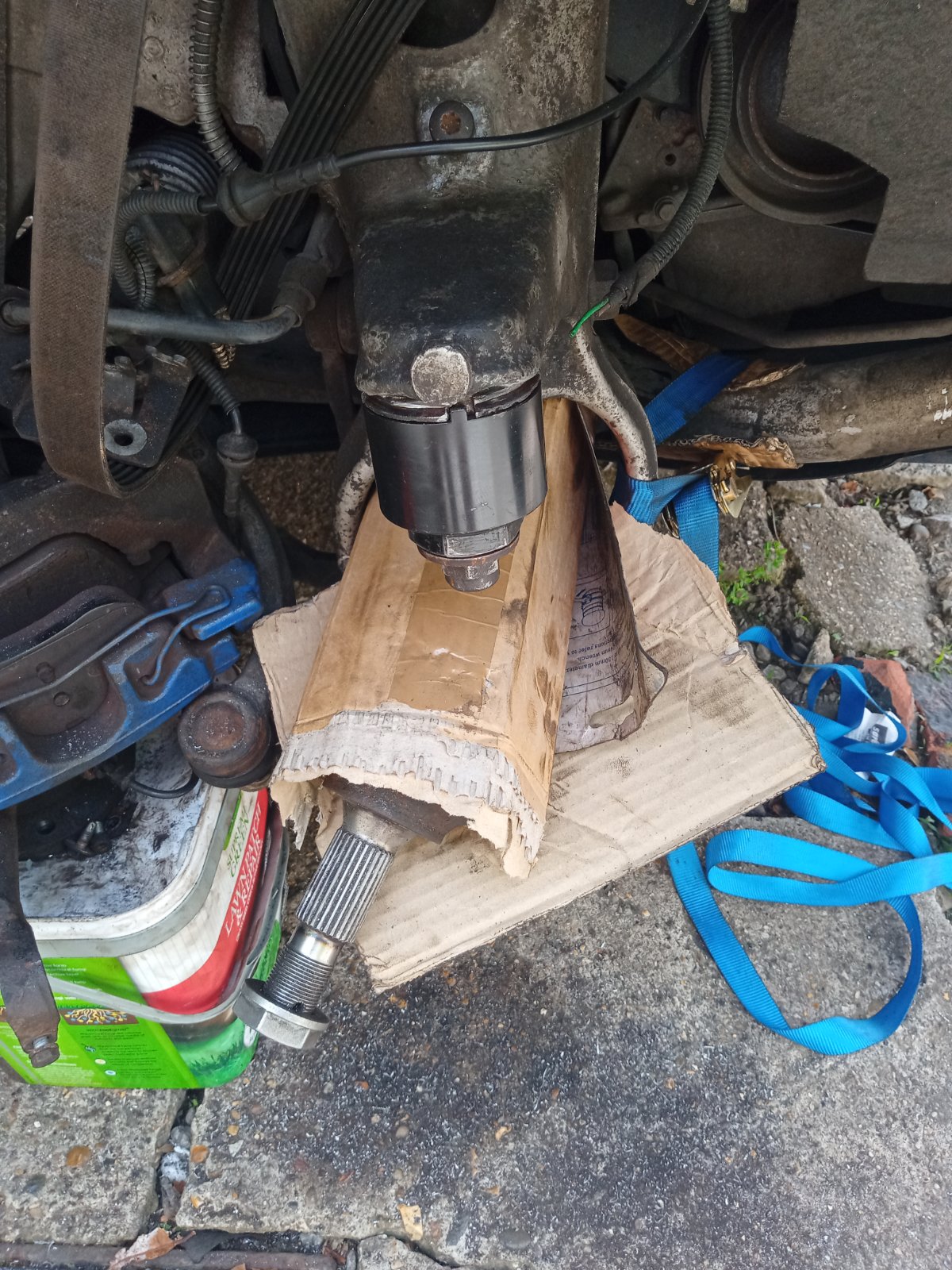

Surprisingly, the lower ball joint was easy to replace, but the upper one is completely stuck... I do have the good socket, tried with a 1 meter extension...and it even broke my extension! Any advise ? I am thinking of buying a powerful impact driver, or buying a complete "arm/pivot" from breaker...

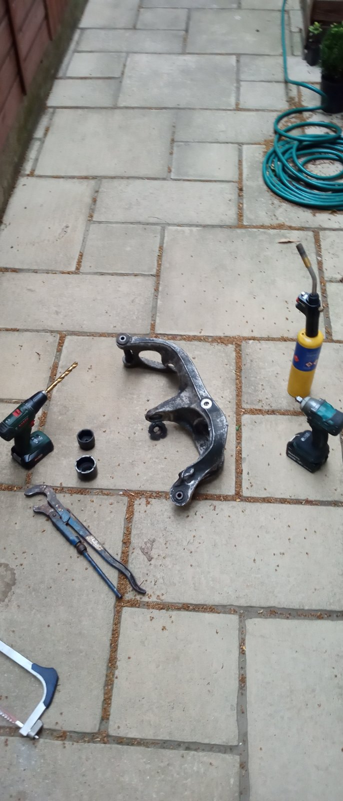

Finnally got it!! Such a hard thing to do ... I think what helped me was to cut the ball joint short, so the heat could reach the thread better.

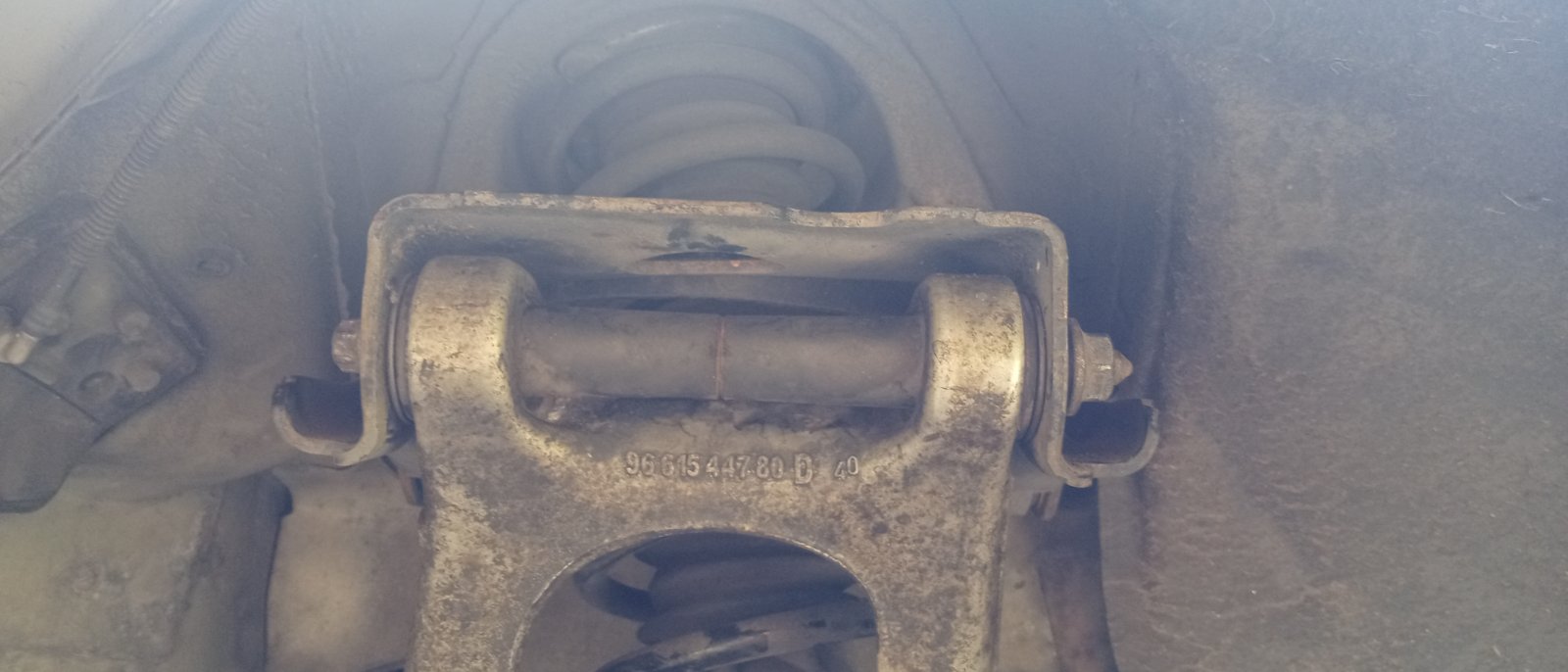

Now, I feel like the screw going through the pivot holder, at the top, can move... The bushes are not holding the screw tight into the pivot holder:is it normal? Doesn't feel like, but I can't see any part worn... As I am there, I would like to be sure before reinstalling everything :D
