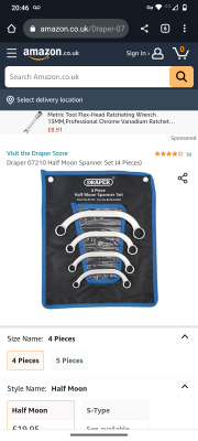

There's another one, I think you can just see it on the second pic at the end of the RH arrow, this is the one you need the crescent wrench for...

Fits those star-shaped nuts perfectly.aerodynamica wrote: 04 Apr 2022, 20:24RichardW wrote: 04 Apr 2022, 20:20 There's another one, I think you can just see it on the second pic at the end of the RH arrow, this is the one you need the crescent wrench for...hmmm, crescent wrench.....

myglaren wrote: 04 Apr 2022, 20:32aerodynamica wrote: 04 Apr 2022, 20:24RichardW wrote: 04 Apr 2022, 20:20 There's another one, I think you can just see it on the second pic at the end of the RH arrow, this is the one you need the crescent wrench for...hmmm, crescent wrench.....

I have refitted an overhauled pump back onto the engine simply by aligning the dirty marks, and it ran fine, I fitted a replacement (scrapyard pump) to an engine and it ran awful, i tried moving the pump a bit a couple of times but it was a massive pain in the arse and amounted to pure guesswork, I did learn that a tiny movement makes a huge difference, I would suggest getting hold of the gear and doing it correctly, it is not like tweaking a distrbutor a bit until it sounds sweet. and yes, I used one of those "access spanners" to get at the special bolt

Ace, well I have similar spanners on order now. Thinking about it, I can't believe I've had the diesel timing out all this time. I was aware the dimension would alter marginally but didn't think it would have such an effect. I mean only a few thou was skimmed off - really just to clean the face. I'll admit I didn't measure the piston tdc protrusion for gasket selection because my understanding was there no longer is a choice of gaskets and that only the thickest one was now available. In fact it might be that the dimension is oversized instead. That will have lowered the compressions a bit too. I think the retightening of the head bolts may have compressed the gasket further as well but it's likely still a bit over. If so the diesel timing might be a bit advanced instead of retarded. Anyway, it remains to be seen!

Ok! Well I moved the timing by about 1mm retarded and tick over seems to have increased rpm when cold. Does seem a bit smoother.

Thank you Richard for the spanner suggestion - ideal
