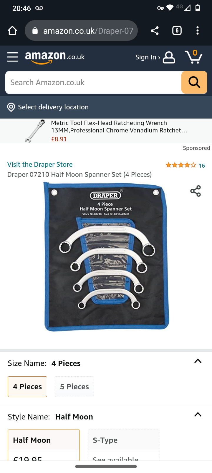

There's another one, I think you can just see it on the second pic at the end of the RH arrow, this is the one you need the crescent wrench for...

Fits those star-shaped nuts perfectly.aerodynamica wrote: 04 Apr 2022, 20:24RichardW wrote: 04 Apr 2022, 20:20 There's another one, I think you can just see it on the second pic at the end of the RH arrow, this is the one you need the crescent wrench for...hmmm, crescent wrench.....

I have refitted an overhauled pump back onto the engine simply by aligning the dirty marks, and it ran fine, I fitted a replacement (scrapyard pump) to an engine and it ran awful, i tried moving the pump a bit a couple of times but it was a massive pain in the arse and amounted to pure guesswork, I did learn that a tiny movement makes a huge difference, I would suggest getting hold of the gear and doing it correctly, it is not like tweaking a distrbutor a bit until it sounds sweet. and yes, I used one of those "access spanners" to get at the special bolt

Ace, well I have similar spanners on order now. Thinking about it, I can't believe I've had the diesel timing out all this time. I was aware the dimension would alter marginally but didn't think it would have such an effect. I mean only a few thou was skimmed off - really just to clean the face. I'll admit I didn't measure the piston tdc protrusion for gasket selection because my understanding was there no longer is a choice of gaskets and that only the thickest one was now available. In fact it might be that the dimension is oversized instead. That will have lowered the compressions a bit too. I think the retightening of the head bolts may have compressed the gasket further as well but it's likely still a bit over. If so the diesel timing might be a bit advanced instead of retarded. Anyway, it remains to be seen!

Thank you Richard for the spanner suggestion - ideal
