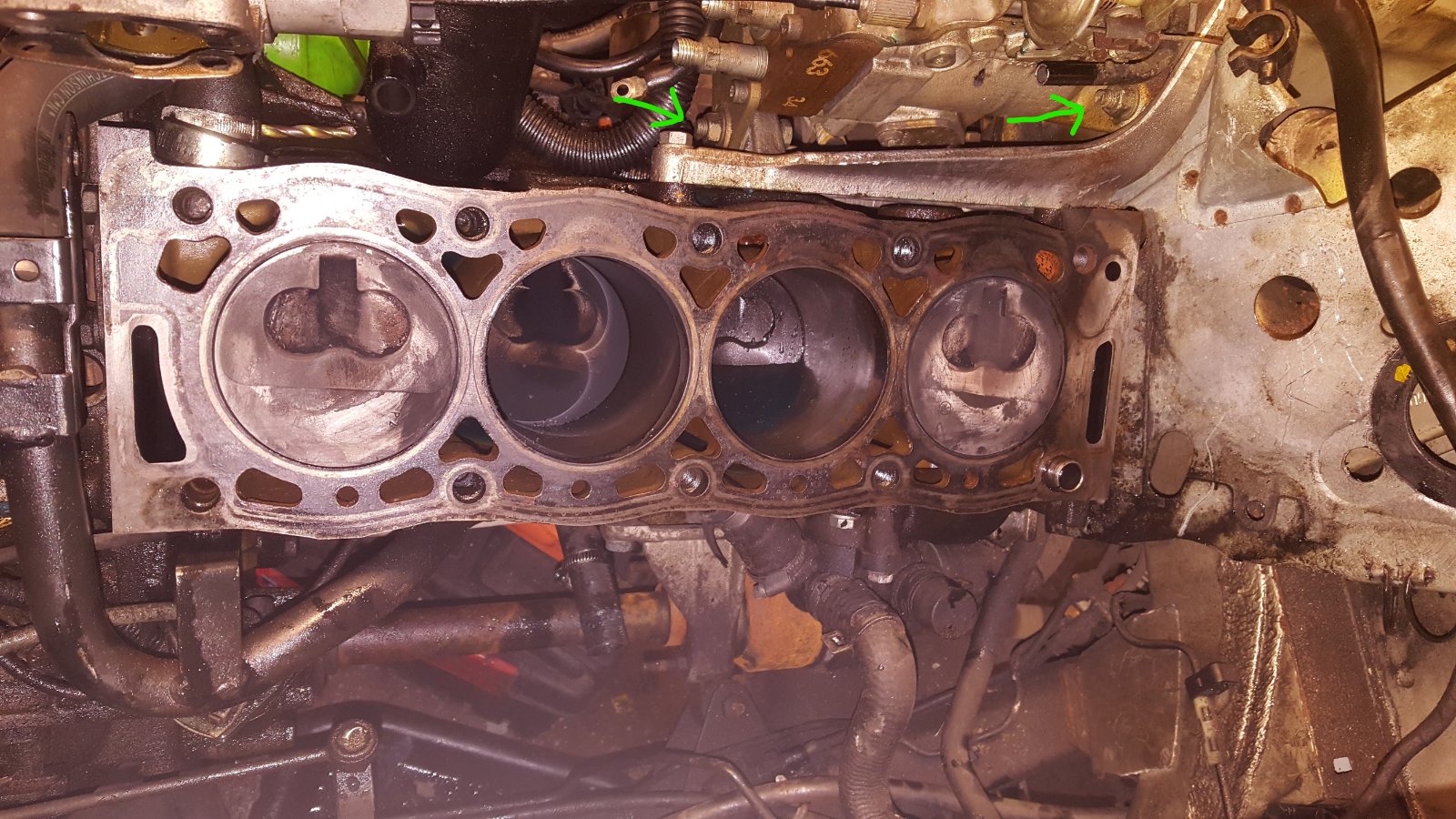

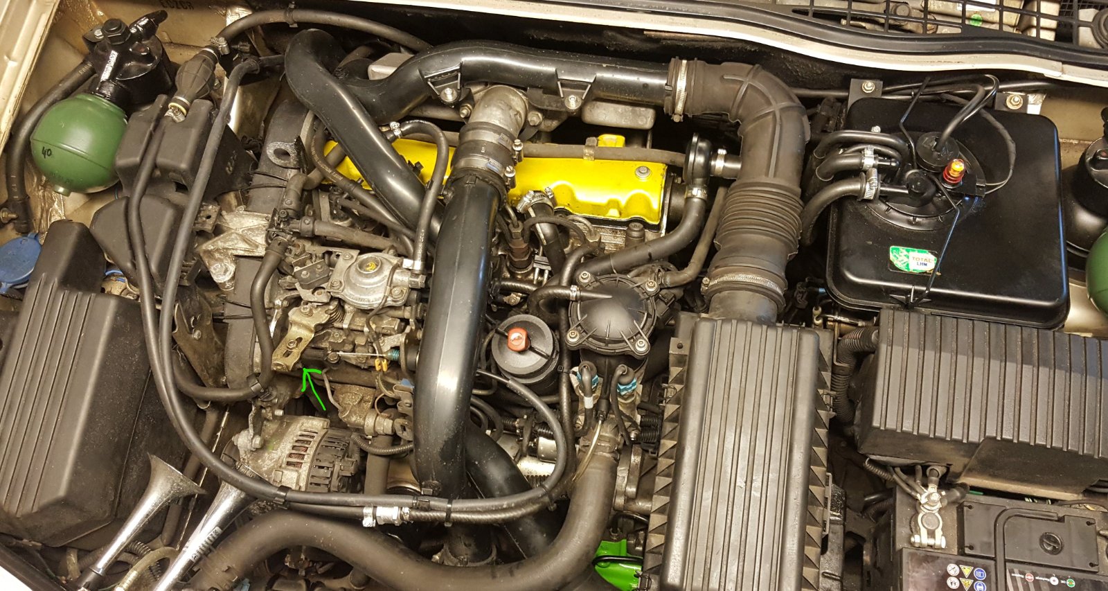

Hi, no I didn't mark it at the time. I'll mark it and move it a small amount although Jim had recommended slackening the 4 diesel injector pipes before moving it because they're tightly fixed.
I see one visible nut at the plate and a second further out towards the centre of the engine - is there a further one or two nuts to slacken?
Here's a snap taken a few years ago
Green arrow pointing to a nut
Does the cambelt cover have to come off to access? (I know - I should just go and look but the car is stored 26 miles away)
another two nuts found looking back through my photos
These two nuts also seen in old photo from 2018 - cylinder head removed for clarity :)
