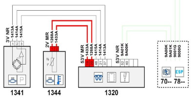

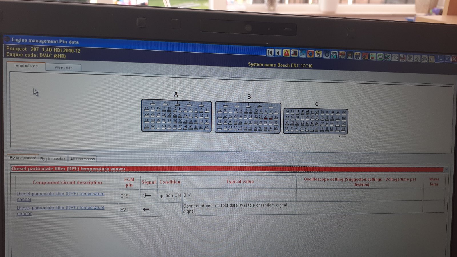

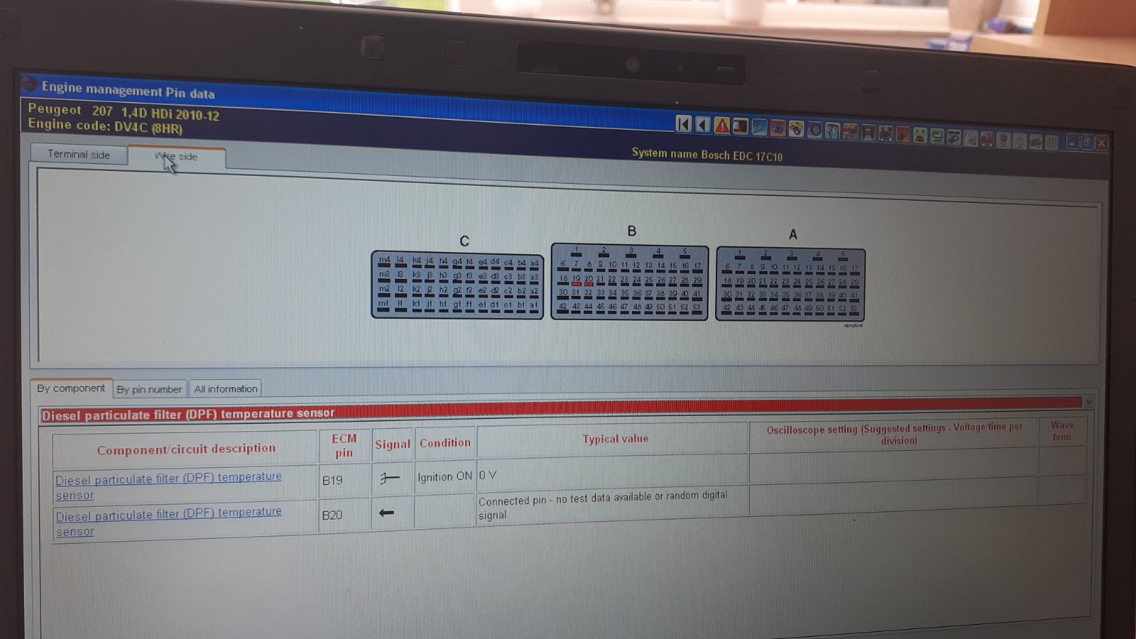

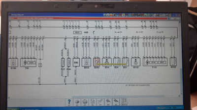

I have located these wiring diagrams....
Am i right in saying they conect to pins B19 and B20
On the ecu?
Thanks for your help
On the ecu?
- x 6946
Re: Exhaust temp sensor wiring
They do: (PS - I deleted your other post on this same subject as it asked the same question, to avoid duplication of answers).
Wire 1268A: exhaust gas temperature sensor downstream of the catalytic converter A: signal is Pin (1) on the Upstream Exhaust Gas High Temp Sensor (UEGHTS)
Wire 1433A: pre-catalyst downstream exhaust temperature sensor earth A: signal is Pin (2) on the (UEGHTS)
These go to the 53 Pin Brown connection plug on the engine ECU:
1268A = Pin (20) on ECU
1433A = Pin (19) on ECU

Thanks Marc that's much appreciated i will take a look and report back
Thanks again
Thanks again

Well checked the wires back to the ECU plug and all ok, so not sure what to check now
Thanks all
Thanks all

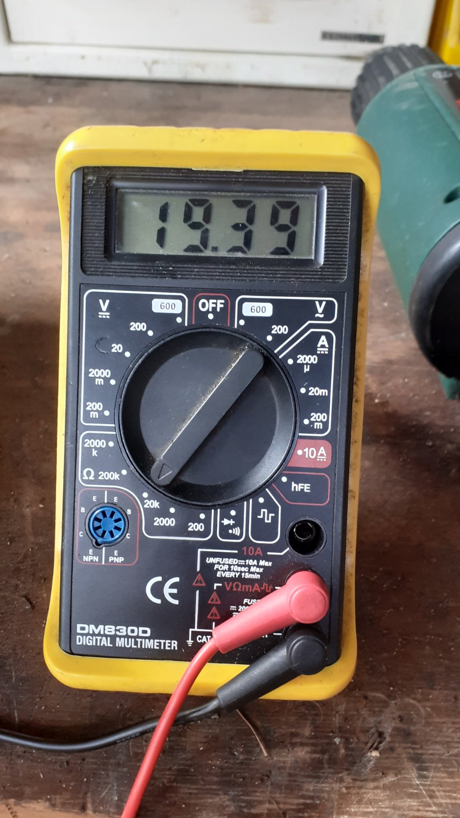

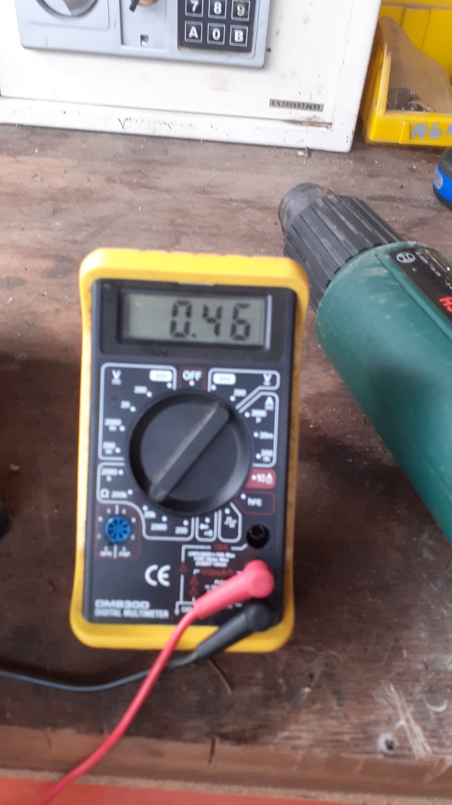

Took some readings of the exhaust gas temperature sensor today on the bench

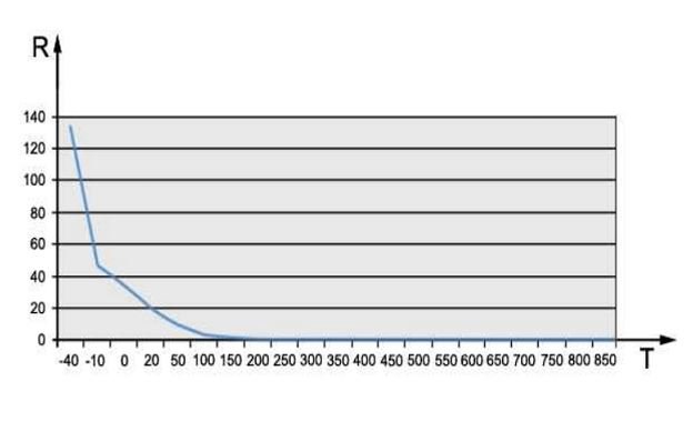

Ok Simon, this may help with the readings:
The gas temperature sensor upstream of the particle filter informs the engine ECU of the temperature of the exhaust gases.
The NTC (Negative Temperature Coefficient) resistance value "R" changes in relation to the change in the temperature "T":
- When the temperature "T" increases, the resistance value "R" decreases
- When the temperature "T" decreases, the resistance value "R" increases
