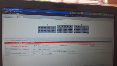

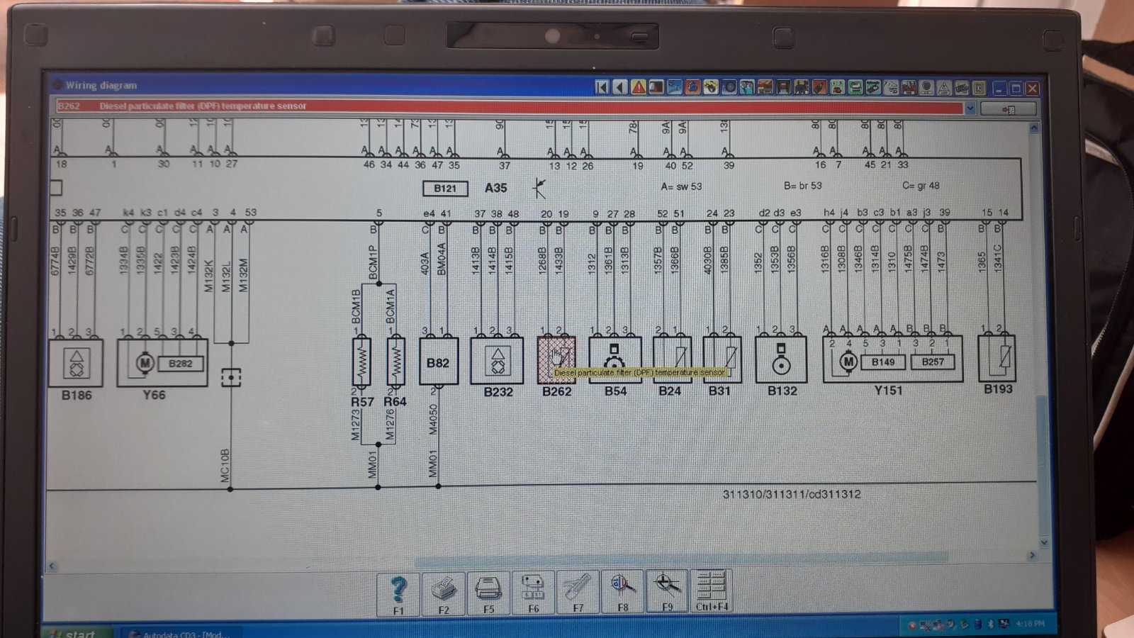

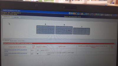

I have located these wiring diagrams....
Am i right in saying they conect to pins B19 and B20
On the ecu?

They do: (PS - I deleted your other post on this same subject as it asked the same question, to avoid duplication of answers).
Wire 1268A: exhaust gas temperature sensor downstream of the catalytic converter A: signal is Pin (1) on the Upstream Exhaust Gas High Temp Sensor (UEGHTS)
Wire 1433A: pre-catalyst downstream exhaust temperature sensor earth A: signal is Pin (2) on the (UEGHTS)
These go to the 53 Pin Brown connection plug on the engine ECU:
1268A = Pin (20) on ECU
1433A = Pin (19) on ECU

Well checked the wires back to the ECU plug and all ok, so not sure what to check now
Thanks all

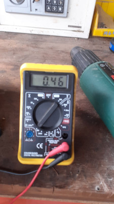

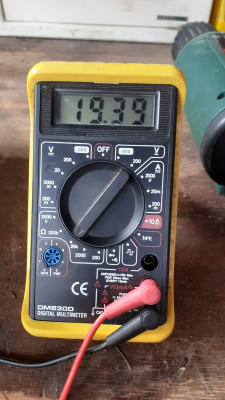

Took some readings of the exhaust gas temperature sensor today on the bench

Ok, so just to rewind a bit, you never actually stated what the issue was, but just asked for the wiring info, which has helped you do your checks I see, but I'm not sure what the fault is to start with.
If you can provide some more information and some fault codes for the specific issue, maybe we can chip in.

Sorry Marc
The car is running absolutely fine and no fault codes or warning lights on the dash what so ever, and is doing regenerations every 220miles,
Previously my dpf was blocked and while i was trying to get information on that issue it was pointed out to me that my exhaust gas temperature sensor was reading 149°c constantly... with a live scan showing this, it's been suggested that my car may be chipped but as far as I'm aware its not as the dpf is all still in place as ive just recently removed it and cleaned it.
And since putting it back together the cars been fine, but live data still showing a constant 149°c
Many thanks Simon

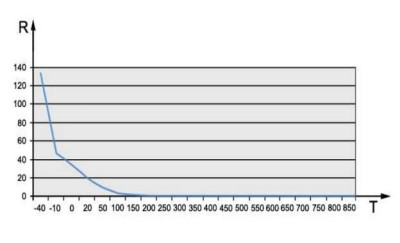

Ok Simon, this may help with the readings:
The gas temperature sensor upstream of the particle filter informs the engine ECU of the temperature of the exhaust gases.
The NTC (Negative Temperature Coefficient) resistance value "R" changes in relation to the change in the temperature "T":
- When the temperature "T" increases, the resistance value "R" decreases
- When the temperature "T" decreases, the resistance value "R" increases
| Minimum value (°C) | Temperature (°C) | Maximum value (°C) | Resistance R (In Kohms ) |
| -50 | -40 | -30 | 133,8 |
| -20 | -10 | 0 | 46,76 |
| -10 | 0 | 10 | 34,49 |
| 10 | 20 | 30 | 19,86 |
| 40 | 50 | 60 | 9,748 |
| 90 | 100 | 110 | 3,770 |
| 140 | 150 | 160 | 1,802 |
| 190 | 200 | 210 | 1,001 |
| 240 | 250 | 260 | 0,616 |
| 290 | 300 | 310 | 0,412 |
| 340 | 350 | 360 | 0,293 |
| 390 | 400 | 410 | 0,218 |
| 440 | 450 | 460 | 0,168 |
| 490 | 500 | 510 | 0,134 |
| 540 | 550 | 560 | 0,109 |
| 590 | 600 | 610 | 0,090 |
| 640 | 650 | 660 | 0,076 |
| 690 | 700 | 710 | 0,065 |
| 740 | 750 | 760 | 0,056 |
| 790 | 800 | 810 | 0,049 |
| 840 | 850 | 860 | 0,043 |
