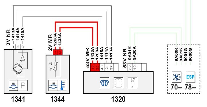

Hi all i hope you are all keeping well,
I'm trying to check my wiring on my exhaust gas temperature sensor back to the ECU,
My chassie number is VF3**************[VIN obfuscated, can be read by forum staff]
I will be totally honest I'm just a diyer on cars and I can obviously see the cable colours at the exhaust gas temperature sensor but I've no idea how to read a wiring diagram to see/know what pin numbers they are at the ECU end.
Any help would be very much appreciated thanks

I have located these wiring diagrams....
Am i right in saying they conect to pins B19 and B20
On the ecu?
Thanks for your help
On the ecu?

They do: (PS - I deleted your other post on this same subject as it asked the same question, to avoid duplication of answers).
Wire 1268A: exhaust gas temperature sensor downstream of the catalytic converter A: signal is Pin (1) on the Upstream Exhaust Gas High Temp Sensor (UEGHTS)
Wire 1433A: pre-catalyst downstream exhaust temperature sensor earth A: signal is Pin (2) on the (UEGHTS)
These go to the 53 Pin Brown connection plug on the engine ECU:
1268A = Pin (20) on ECU
1433A = Pin (19) on ECU

Thanks Marc that's much appreciated i will take a look and report back

Well checked the wires back to the ECU plug and all ok, so not sure what to check now
