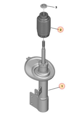

I wish to change front shock absorbers and top mounts on my 5008 vin: VF3**************[VIN obfuscated, can be read by forum staff]
Can i have the part no for.these and top mount assembly illustration please.
Thanks
Thanks

Re: Citroen and Peugeot Official Parts Requests
Here you go Dan
Pair - Left & Right
OEM
Item (1)
9807734180 £105.91
9807734280 £105.91
Cheaper PSA Alternative:
(Left) 1635531780 £81.12
(Right) 1635530980 £81.12
Strut Boot:
Item (2), Part: 525431, £14.03
